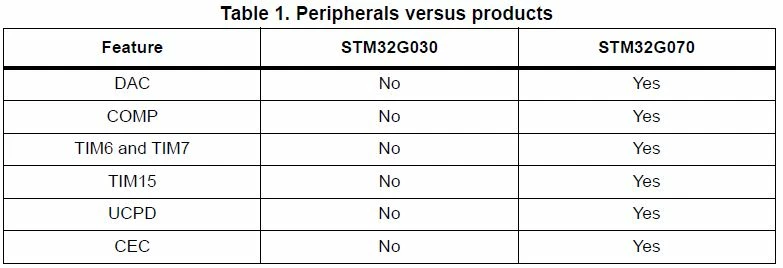

Although STM32G070RB doesn't have USB function, why it has UCPD?
And, I found below table on page.38 of RM045. how is UCPD available in STM32G070RM?
And, do you have any information about below on page.167 of RM0454?
Br,
Yuji
Mike_ST
July 1, 2020
Dear Yuji,
Do you have an older version of the RM0454 ? It seems you have preliminary/early version.
If so, please download Rev 3 from May2020 here:
https://www.st.com/resource/en/reference_manual/dm00463896-stm32g0x0-advanced-armbased-32bit-mcus-stmicroelectronics.pdf
Table seems to have changed and 6.3.15 has been removed.
Best regards,
Mike
FYUJI.1
FYUJI.1Author
July 2, 2020
Dear Mike
I downloaded the latest version, and confirmed revision points.
But, I still don't understand why this STM32G070 has the UCPD res,and how we utilize it because this ucom doesn't have usb function.
Anyway, i understand the UCPD res is 5.1k and it is not identical to GPIO PUPUD(set by GPIOx_PUPDR).
Br, Yuji
waclawek.jan
July 2, 2020
Power delivery protocol is entirely separate from actual USB data transfer, using separate conductors in the cable. Actually, as of today, charging-only USBC cables (i.e. without the USB data conductors) may quite well be the prevalent type.
OTOH, 'G0 models with USB module are promised to come ever since the 'G0 line appeared (search on this forum).
