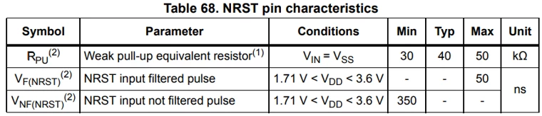

According to the Datasheet (DS) and Reference Manual (RM), I confirmed that the NRST pin has an internal weak pull-up (RPU), which is typically 40 kΩ.

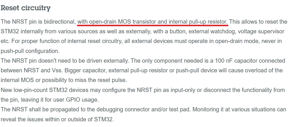

Although the Datasheet and Reference manual do not explicitly disclose the internal circuit diagram of the NRST pin used during NVIC_SystemReset, I found information in the community stating that NRST internally has an "Open-drain" structure.
link : https://community.st.com/t5/stm32-mcus/why-my-stm32-doesn-t-start/ta-p/49367

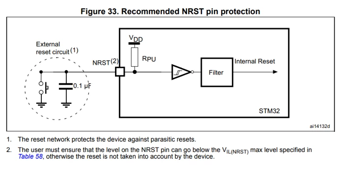

Therefore, I assume the circuit topology is as follows:
  • Rpu: STM32 internal weak pull-up (typically 40 kΩ)
  • Rnrst: The external pull-up resistor we attached (currently 10 kΩ)
  • Vnrst: The voltage input to the STM32
  • Rnmos: The channel resistance when the NMOS is turned ON
  • Vsystem_reset: The system reset voltage to open the channel during NVIC_SystemReset
My understanding of the operation is as follows:
  1. When an internal reset occurs: The internal logic turns the NMOS ON → NRST falls to LOW, triggering a reset.
    • Condition: It must be below VIL. (We use VDD = 3.3V, so VIL should be around 0.99V).
When the NMOS turns ON, it will appear as a resistor due to its internal resistance (Rnmos).
During the reset drive, the voltage at the NRST pin will be divided as follows:
Vnrst = VDD × (Rnmos / Rtotal + Rnmos)
The equivalent resistance of the parallel pull-up resistors is:
Rtotal = (Rpu × Rnrst) / (Rpu + Rnrst)
If Rnrst is much smaller than Rpu, Rtotal will effectively be seen as Rnrst (the external pull-up we attached).
If we consider a case where Rnmos is equal to Rtotal, then Vnrst would be 1.65V, which is far above the VIL threshold.
Consequently, NVIC_SystemReset would not function correctly.

  2. Is there a guaranteed specification for the sink capability (VOL vs IOL) of the NRST pin when it drives low during a SW reset?
  3. Is there a minimum recommended value (or a prohibited range) for the external pull-up resistor on the NRST pin to ensure proper reset behavior?
I looked through the datasheet, but I could not find the VOL and IOL specifications for the NRST pin

I don't have the specifications either, but NRST is a bidirectional pin that can also drive external circuitry.
Let's do some rough calculations: in my opinion, a maximum current of 1mA can be driven there without any problems, which at 3.3V allows a resistance of down to 3.3k. The pin can probably handle even more current, which further reduces the drivable resistance.

This is still a common misconception, the origins of which date back to the last millennium when external pull-ups were connected to reset pins of ancient microcontrollers (the pensioners among us still remember: aaah, back then...). An external pull-up is NOT necessary, as you yourself have deduced from the internal pull-up. This renders any discussion about levels and potentially poor Rnmos obsolete.
