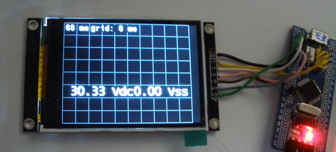

AScha.3
Jun 22, 2025 7:18 AM UTC
Right, see my pic...its just on a bluePill , F103 , 7 wires to display.
