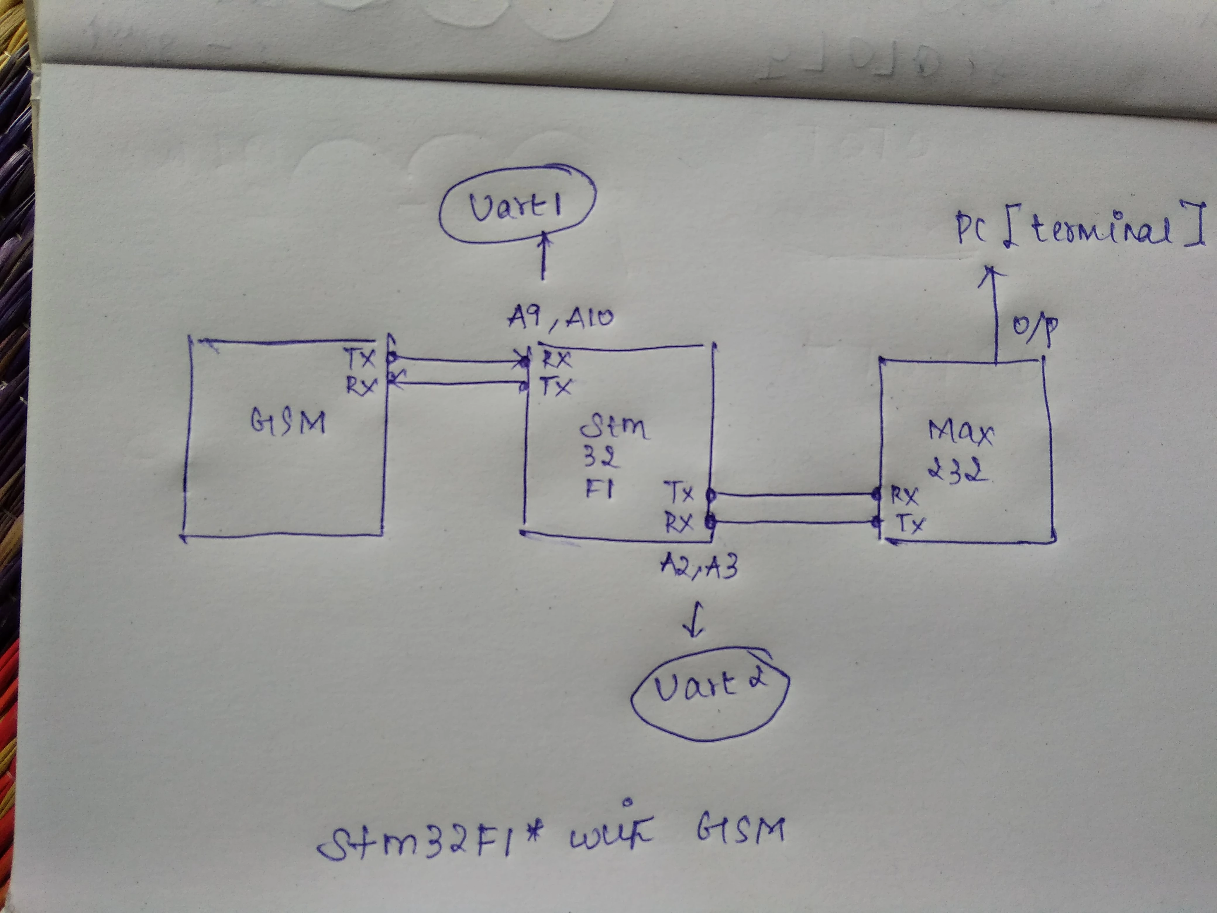

I am trying to interface GSM with my ARM controller [stm32f103c8t6].
I knew a little about the working of GSM,
- By sending the "AT" command to GSM, it will respond with a "OK" message.
Before interfacing GSM with arm, i learned how to use HAL_uart function (generated from cube MX). I tried to transmit and receive data to "arm and terminal(pc)" , and it works good in HAL_uart function.
Problem:
- But when i connect to GSM with ARM, No response is getting from GSM.
- I tried another method, i use uart max232 with GSM to transmit and receive data it works fine. [sending data to pc terminal via max232].
I attached the uart communication diagram arm,gsm and max232.(I use max232 to communicate with pc since i have only st-link v2 which has no tx and rx).
Also the code generated from cube mx.

    I don't think synchronous polling approach is OK for this type of application (especially when you don't know how much data you gonna get on rx), but obviously you are a novice in microcontroller programming, so let's try to solve your current problems first.
    > HAL_UART_Transmit(&huart1,atcmd,10,10);
    Why 10, 10? Your AT\r\n command is 4 bytes long. 10ms is OK for sending 4 bytes, so the second 10 is OK, but the first one should be 4 (you are currently sending 6 more "garbage" bytes to the modem).
    > HAL_Delay(200);
    > HAL_UART_Receive(&huart1,rx,10,10);
    Again, why 10, 10? Also, while you are delaying 200ms the answer is already sent by the modem, so when you try to receive the data it's already late. Delete the delay, use longer timeout for receiving if 10ms is too little.
