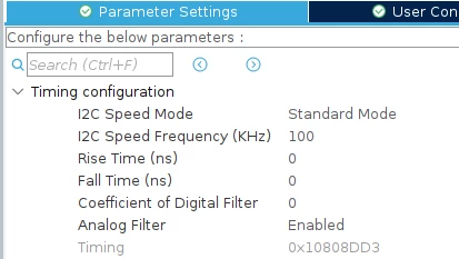

NSing.5
NSing.5Author
July 8, 2024
And enable the noise filter(s) .
plz tell me how to enable filters for i2c
AScha.3
July 8, 2024
here analog filter on, + dig.filter : if you wanna use, just set it: 0...15 possible.
