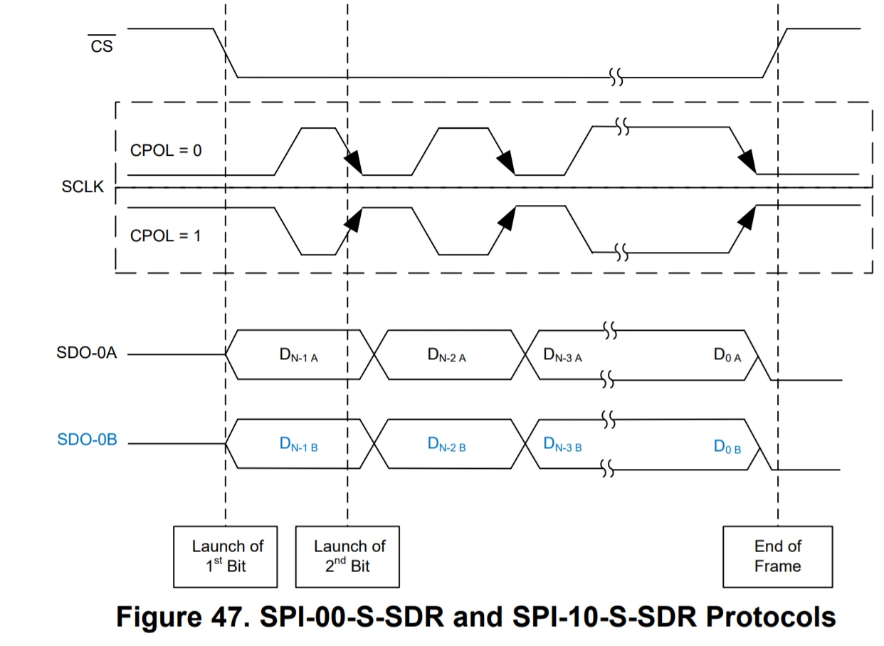

ADC Timing Diagram
0693W00000KZlwCQAT.pngThe ADC can provide samples at up to 3M/s. I would be happy to achieve ~0.8M/s sampling.

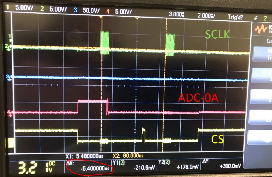

Running the following code to initiate back to back SPI reads:
HAL_GPIO_WritePin(GPIOB, GPIO_PIN_6, GPIO_PIN_RESET); //CS LOW
 HAL_SPI_Receive(&hspi1, (uint8_t *)spi_buffer, 1,40);
 HAL_GPIO_WritePin(GPIOB, GPIO_PIN_6, GPIO_PIN_SET); //CS high
Produces the following timing:
The STM32 is operating at 180MHz, and the SPI CLK is at ~30MHz. You can see that once the SPI initiates it is very fast, but the time to initiate the next SPI read is taking too long (~6us) which is limiting the rate at which I can read from the ADC.
