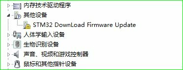

Hi guys,
I wanted to test DFU function with my STM32F401 board, and my Win7 has installed DfuSe V3.0.4. After I plug USB to PC, it shows the driver is not corrected, so DfuSe can't recognized the USB device.
I searched the forum but havn't find a solution, can anyone give some advices? thank you very much!

    Posted on August 11, 2015 at 04:41
    You can find the screen shot here:

    Do you have any settings/policies in your Win7 install that might preclude the loading of drivers, or expect them to be signed etc? Are you an Administrator on the machine? Do you have IT people responsible for the machine?
    Having installed the DFU software, there should be a driver directory, run the explicit installer if you need too.
    C:\Program Files (x86)\STMicroelectronics\Software\DfuSe\Driver
    Does Windows provide a specific error? Or just that it can't/won't load the driver?

    Posted on August 14, 2015 at 09:47
    Hi Clivel,
    Thank you very much!!
    It'm my computer's problem. I used another PC just now, and successfully upgraded my board through system DFU bootloader now:-)

    Dear All,
    I've exactly the same problem. New PC with Win 7, the board is not recognized by DFUSe 3.0.5.
    The device manage shows the same problematic icon with exclamation point.
    Other PC on Win 10 hasn't that issue.
    I tried with anothe Win 7 PC and the problem is the same.
    Would you have a corrected driver for Win 7 ?

    I would like to confirm that I'm also experiencing the very same issue on Win7 64-Bit. Windows enumerates the device and I can see it in DM as "STM32 bootloader" however, it is not detected in DfuSe. I tried restarting, switching pins, nothing worked!
    Pavel A.
    January 21, 2019
    It is not the very same issue. The OP experienced issue with installing the driver correctly (yellow bang in Device Manager). In your case, it looks like the driver installs correctly, but the DfuSe won't find the device for some reason.
    -- pa
