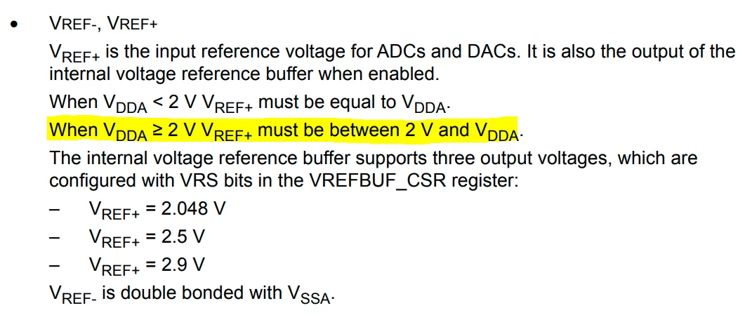

On default VREF+ pin in an input. You can connect an external reference to this input, then the max level for the ADC input is the VREF+ voltage. EDIT: You can't use an external référence of 1V.
The VREFBUF is not a pin but a switch to connect the internal reference voltage to the VREF+ pin.
The VREFBUF is used to set the VREF+ pin as output. The max level for the ADC input is also the VFERF+ voltage.  In this mode the allowed VREFBUF voltage depends on the VDDA voltage.
In your case  you must use an external reference connected to the VREF+ pin and ignore VREFBUF.

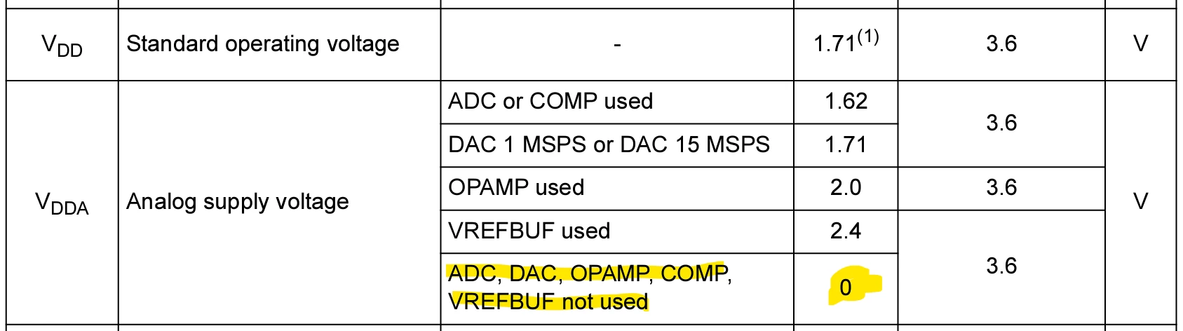

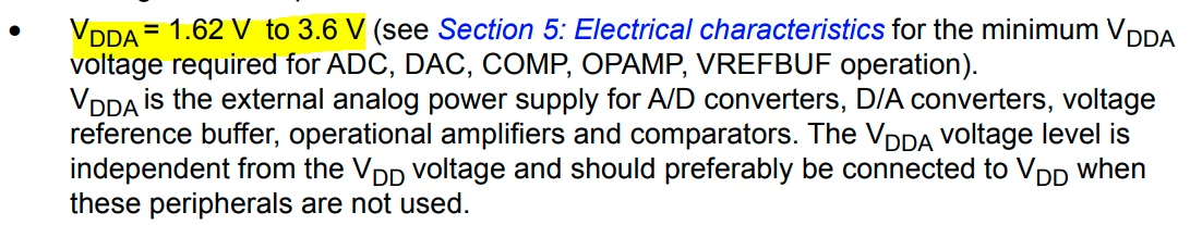

There are limits on the range of allowable voltages on VREF+ which can be found in the datasheet. If you are tying VDD to VDDA, generally it's going to be limited to 2V+.
If you handle VDDA separately, you can get down to 1.62V.
In either case, you can't get down to 1V for the entire 12 bit swing.

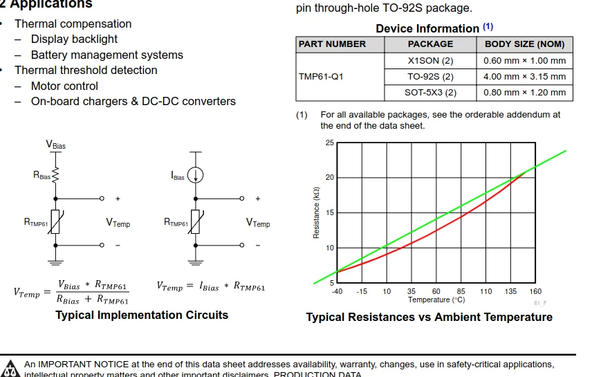

We do not intend to use the internal temperature sensor, we are using 4 x external TMP61 thermistors for remote sensing, & these sensors when used with Voltage divider design have a very low voltage swing over entire temperature range.

About sensor curve, TMP61-Q1, it reminded me of sensor curve KTY84. In the KTY84 datasheet it says that it is "Virtually Linear" note that there is a deviation, the curve is not completely linear (which would be a straight line, not a parabola) some compensation may be needed depending on the range and accuracy desired. On a device that uses the KTY84 I had to deviate the extremes via trimpot calibration, so that the center of the curve was closer to the average.
I am including the TMP117 sensor (+/-0.1°C) in another project that was operating with the DS18B20. This TMP117, despite being expensive compared to a thermistor, seems to be worth it, since it is a digital sensor, I2C bus (it could be even better if it were 1-wire like the DS18B20).
