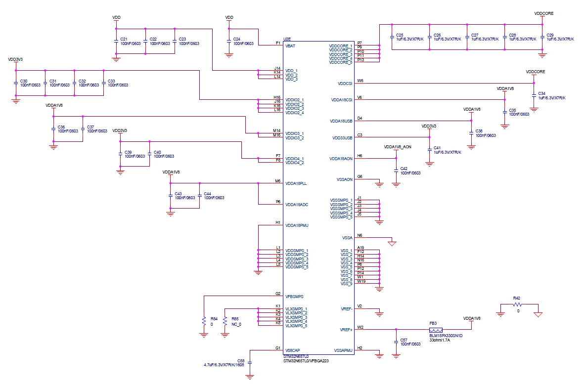

I am currently developing a USB Device application using the STM32N657L0.
I am reaching out to ask for advice because I am having difficulty meeting the target power consumption requirement of 5V, 2mA max during USB Suspend state.
Our target conditions and system requirements are as follows:
  1. VDDCORE uses an external power supply.
  2. The USB Driver must be maintained during USB Suspend.
  3. The system must be able to wake up and recover via USB.
  4. Power consumption must remain below 5V, 2mA during USB Suspend.
Currently, when the chip is configured in STOP Mode, the measured power consumption is:
  1. VDDA18AON (1.8V): ~5mA
  2. VDDCORE (0.81V): ~40mA
We are looking for ways to further reduce these currents to meet the 2mA requirement.
Could you please guide us on how to optimize the power modes, clock gating, or power supply configurations to achieve this? Any suggestions or reference guidelines would be greatly appreciated.
Thank you for your support.

Hi ​@brenda00
Can you share schematics? Did you try to reproduce using reference board?

brenda00Author
Sep 29, 2026 4:23 AM UTC
Thank you for your response. Please find our feedback on the items below:
  1. We have not yet tested this on the Reference Board(NUCLEO-N657X0-Q).
  2. We replaced the STM32N657L0 with the STM32N655L0 and tested it, but observed the same results:
    • VDDA18AON (1.8V): ~5mA
    • VDDCORE (0.81V): ~40mA
  3. Please understand that we cannot share the full schematic due to confidentiality. Instead, I have attached key excerpts of the relevant schematic sections.
Please let us know if you need any additional details based on the provided circuit snippets.
Best regards,

brenda00Author
Oct 19, 2026 1:32 AM UTC
Hello FBL,
Thank you for your quick response and guidance.
Since our system operates directly on VBUS power, the current measured at VBUS reflects the total consumption, including the MCU's current during STOP MODE. This is why we measured and analyzed the individual current draw for each MCU power rail.
Thank you once again for your assistance.
Best regards,
Oct 19, 2026 6:25 PM UTC
Hi ​@brenda00
The datasheet specifies Stop mode current supply rails under these defined conditions. Based on the measured rail voltages and currents, the combined power is approximately 41.4 mW. If this power is supplied from USB VBUS, it corresponds to at least 8.3 mA at 5 V under ideal conditions , so a 2 mA VBUS target would not be achievable in that configuration. In general, it is recommended to put unused GPIOs in analog mode and disable peripheral and bus clocks that are not needed based on your application.
