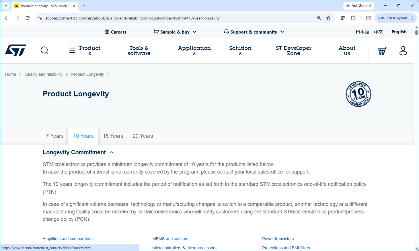

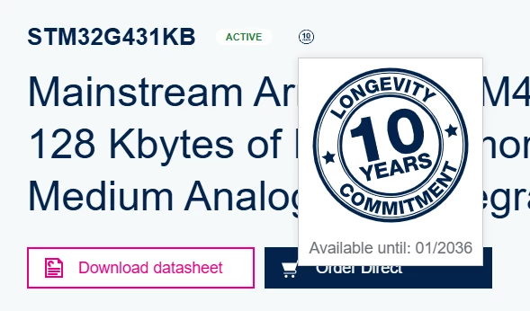

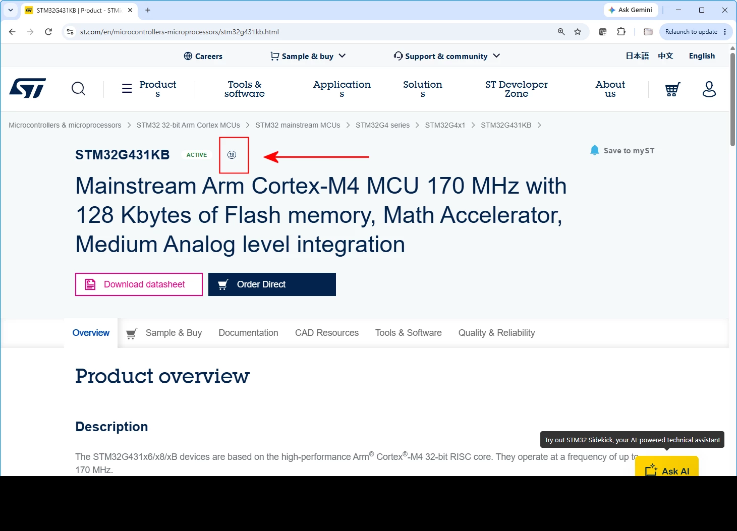

You can find the longevity commitment on the Product Page; eg,
Hover your mouse over the icon for more details:
Click it to get full details:
Beyond that, you’ll need to contact your local ST Sales office or Distributor:
https://www.st.com/content/st_com/en/contact-us.html
Or raise a Support Case:
https://ols.st.com/s/
