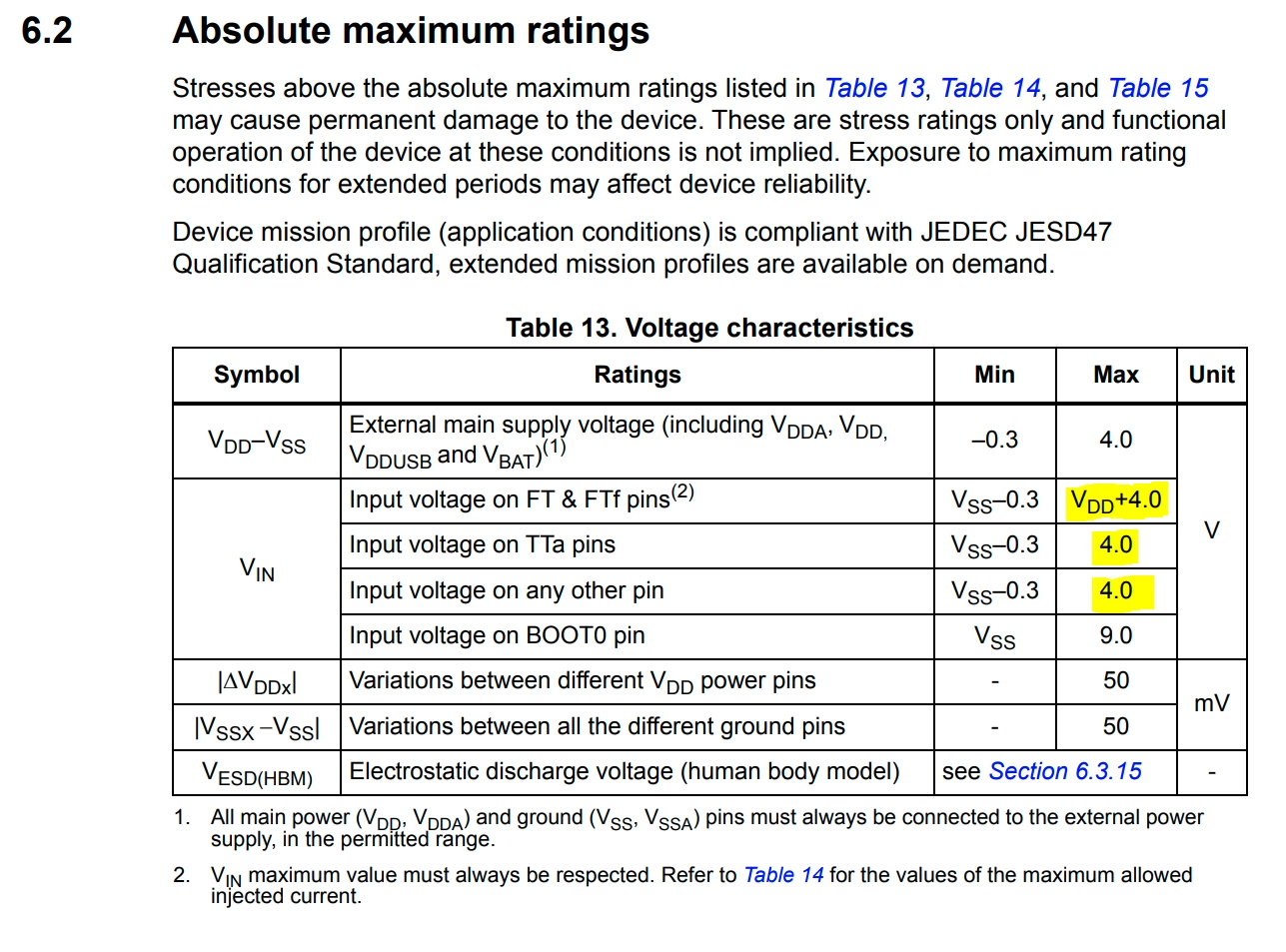

Input signal when MCU is powered off
I will make some probes for reading electrical values (AC, Analog, digital,...), but I'm not sure what happens if I insert a signal to a GPIO when MCU is powered off.
I read time ago that all GPIOs are in high impedance state when MCU is not powered but I don't see this information in datasheets. It's the most logical, but I need to be sure for the safety of MCUs.
The MCUs that I will use are
STM32F446 (Nucleo board)
STM32G030 (Homemade boards)
STM32F103 (Blue Pill)
Thanks

If uCPU power is off, than no lines with voltage should be connected to inputs. Exception is only for high impedance signal sources, or you can intentionaly insert resistors in series with inputs. Injection current specified in the DS, usualy < 1mA, but better option would be optoisolation, there are analog galvanic isolation IC as well as digital

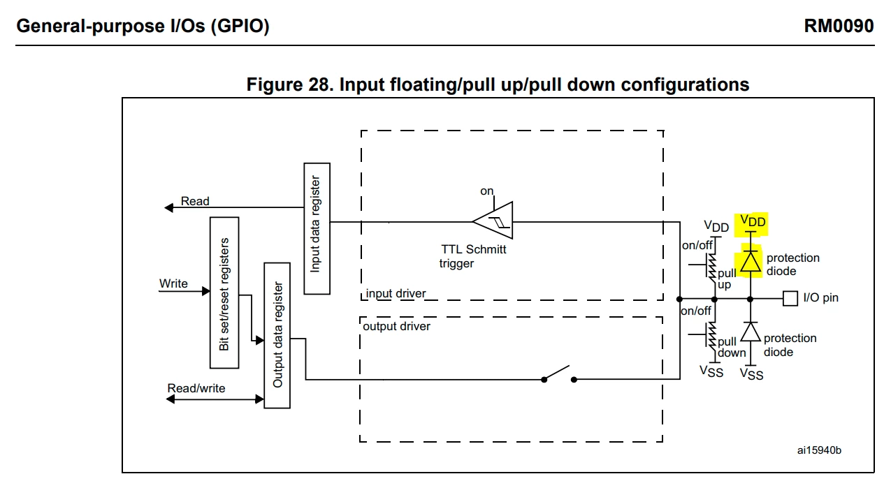

They're mostly in high impedance mode, but the protection diodes are still present.
Look at the "Voltage characteristics" table in the relevant datasheets. Generally an input voltage of 3.3V is fine. More than that can be problematic. Depends on the exact pins you're using.
Also look at the GPIO port structure in the reference manual for understanding.

> Obvious, if this diode were present, will be impossible to input a voltage >VDD+0.6V.
It's certainly possible if the protection diode for FT pins is a 4 V zener, which the evidence strongly suggests.

Yes, it looks like a zener diode in series with a rectifier diode to avoid the forward polarization current of the zener diode.
