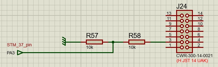

I have set PA3 pin as input with pull up mode. But testing this pin by multimeter I get high impendance state (0.5V) on it. Must be 3.3V (logical 1). I use stm32F417ZGT6.

Note, that the internal pullup is nominally 40kOhm, so it won't provide enough current to overcome an external 10kOhm pulldown to a valid logic 1 state.
Actually, if VDD is around 3V, a 40kOhm/10kOhm divider you have should result in cca 0.6V, matching your observation.

September 18, 2025
Schematic of PA3 port connecting
September 17, 2025
The attached code initialized PA3 as input with pullup. No problems there. Nothing special about PA3.
The issue is likely with your hardware. It's also possible you're not measuring the actual pin. Show a picture of your setup, schematic, and what you're actually measuring.
September 18, 2025

September 18, 2025
What I should to do to have logical 1 on PA3 input with pull up mode?
September 18, 2025
Remove your external resistors...
September 18, 2025
I see... maybe... My mentor something about this possible necessity was mentioned too. But for this need to dismount resistor from pcb. For this need access to soldering iron. So, it's complicated. Maybe some other ways?
