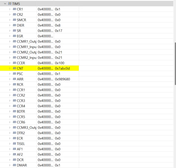

I would like to measure the period of a square wave (around 1 kHz) with a timer in input capture configuration. I am using TIM5_CH3 on pin PA2 (nucleo G474RE).
I would like to receive a bit of help in debugging my code since i am not able to measure the period of an external waveform (also tracked on my oscilloscopes).

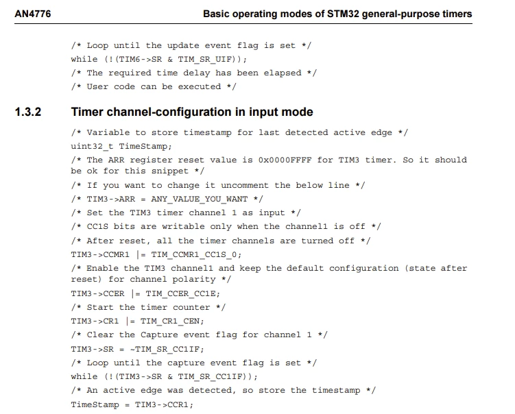

HI @KnarfB​
My goal is to use the register based approach to mesure the period of an incoming square wave.
and basically I followed this paragraph in AN4776
0693W00000Nq7FnQAJ.pngAs you pointed out the PA2 might interfere with STlink in nucleo g474re so I moved to PA6 (TIM3_ch1) but at the end things are not working because CCR1 keeps staying at 0. I have plugged to PA6 a squarewave with suitable voltage levels (0-3v3 at 1 kHZ).

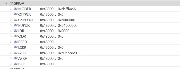

waclawek.jan
May 17, 2022 4:33 PM UTC
Check/post registers' content.
Also try this the other way round: generate PWM onto PA6 from TIM3_CH1, and measure it.

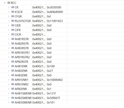

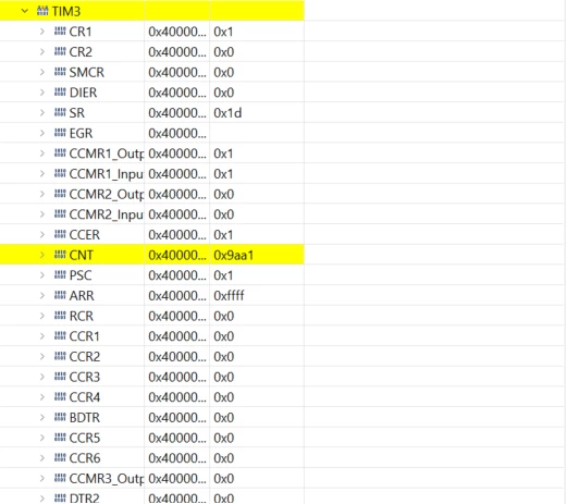

Tommino
TomminoAuthor
May 18, 2022 9:15 AM UTC
HI @Community member​
These are the registers settings while I am doing input capture on PA6/Tim3_Ch1 with the code I shared in my last post
Ok I will try also to generate a pwm with this timer. I will let you know as soon as I do it
Thanks a lot
waclawek.jan
waclawek.janBest answer
May 18, 2022 3:52 PM UTC
GPIOA->MODER6 = 0xabfff7bf => for PA6 the MODER field is 0b11 - note that GPIOx_MODER in 'G4 is not zero after reset.

Indeed the point is that the reset value is : 0xABFF FFFF (for port A)
However, there is a weird issue coming out when writing the MODER register...
If I write
GPIOA -> MODER |= (1<<13)|(0<<12);
It does not change the register content of mode6
On the contrary if I write
GPIOA -> MODER = 0xabffefff;
It changes the register content of mode6
Have you ever experienced something like this?
KnarfB
May 19, 2022 7:24 AM UTC
The "or" operator can only make a 0 to a 1. You need to mask out bits and set the new value like
GPIOA -> MODER = (GPIOA -> MODER & ~(3<<12)) | (2<<12);
hth
