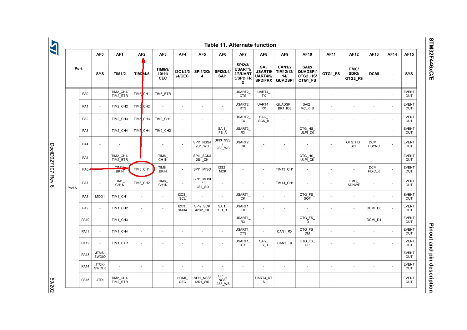

I'm trying to measure a PWM frequency signal using the input capture channel 1 of TIM3, but it won't work.
i'm using NUCLEO F446RE board, here is my code:

In debugging the code stuck here while(!(TIM3 ->SR & (1 << 1))); please any help?
Thank you.

Read back the registers, all of them. Do they contain what you expect?
There should be a few cycles delay after enabling peripheral clocks in RCC (see Delay after an RCC peripheral clock enabling in the errata). I'd just change the order of initialization
RCC ->AHB1ENR |= RCC_AHB1ENR_GPIOAEN; //Enable clock for GPIOA
RCC ->APB1ENR |= RCC_APB1ENR_TIM3EN; //Enable clock for TIM3, provides the required delay
//Configure GPIO
//Configure TIM3
Enable the counter i.e. TIM_CR1_CEN as the last thing after all other timer registers are set up.
Check PA6 - TIM3 mapping in the Alternate function table of the datasheet.

waclawek.jan
Apr 29, 2020 6:56 AM UTC
> GPIOA ->AFR[0] |= 1 << 24; //PA6 is Alternate function 1: 0001
Exactly as berendi said above:

Apr 29, 2020 12:05 PM UTC
Thank you guys for the help, now it's working very well!
