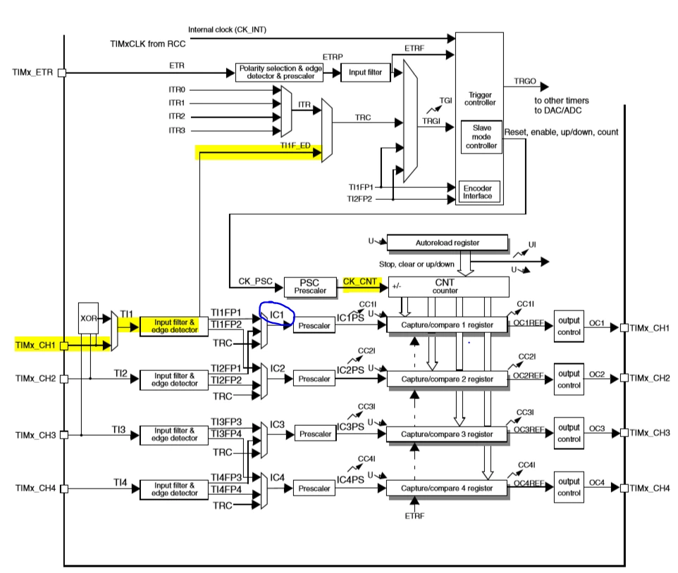

Hello all,
In an external pulse count application, is it possible to capture Timer counts at fixed interval using input capture (IC) module while external input (TIM5_CH1) is driving timer time-base (through TI1F_ED).
I've also tried just storing TIM5->CNT at every RTC interrupt, but found some irregular counts. May be this irregularity is for other interrupts (of high priority) with LP Sleep implementations.
I request some advice on how to configure this capture module (if possible on STML151, clock tree attached). I've configured TIM_5 like this:

    You mention ''irregularity'' but neither define the numbers you are seeing, or the frequency of the signal, or expectations.
    If you had a 1 Hz pulse you could apply that to CH2 and have it latch CNT into CCR2
    You could use another timer, triggering a DMA1 read of CNT, the latency/jitter in that sample point would be smaller than an interrupt.

    I've a fixed custom PCB to work with (~MHz input source for Tim5_CH1). I afraid I can't add any external module/input right now. I guess, internal trigger or another timer can't be applied/routed to TI2.
    From L151 datasheet, DMA requests can be generated from Tim2-7 peripherals only. As internal clock changes in Run/LP sleep mode, I'm trying to avoid Timer internal clock to initiate DMA transfer. Here, only Tim9-11 has (LSE) independent clock source.
    Could you please suggest me an alternative (if any) for this peripheral-memory DMA configuration.
    Thank you for your time.
    You have a more substantial problem. The timers' inputs are synchronized, so you have to have a high-speed APB clock running to be able to run the timer from an external clock. See fEXT specification in the Timer characteristics section of datasheet.

    f_EXT is 0 ~ f_TIMxCLK/2.
    I have a confusion, is it necessary to have fixed processor clock (or APB1 clock) for accurate external pulse count ? If LP_sleep/Run mode toggles, APB1 or TIMxCLK would change.
    I've configured for External clock source mode 1 and reference timing diagram is attached for your kind comment.
