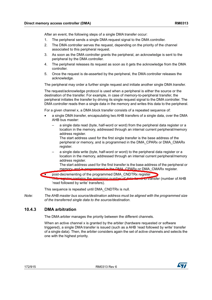

I don't understand.  According to the reference manual, this htim17->hdma->Instance->CNDTR, does not tell me at what index the DMA is going to write inside the buffer?

waclawek.jan
Aug 21, 2021 5:31 PM UTC
Which STM32?
CNDTR indicates you are using a model with single-port DMA. Description of CNDTR in different STM32 models which use it differs, but most if not all explain that it decrements after each transfer.

waclawek.jan
Aug 21, 2021 5:39 PM UTC
0693W00000Dq0HhQAJ.pngwith the caveat I mentioned above. I don't have experience with the single-port DMA in this regard.

So if my reference manual says
 post-decrementing of the programmed DMA_CNDTRx register
This register contains the remaining number of data items to transfer (number of AHB
‘read followed by write’ transfers)
That means if I have 2 bytes buffer and the DMA have already filled 1 index at the buffer, that means CNDTR will show 1?
And when the circular buffer have been filled, then CNDTR = 0 and then directly CNDTR = 2 because not it's starting at index 0 again?
I can intepret CNDTR as how many elements it has left to write?
STM32MP151AAC3 custom board with STM32-OS as operating system: https://github.com/DanielMartensson/STM32-ComputerSTM32MP257FAK3 custom board with STM64-OS as operating system: https://github.com/DanielMartensson/STM64-Computer
waclawek.jan
Aug 21, 2021 8:08 PM UTC
Yes.
