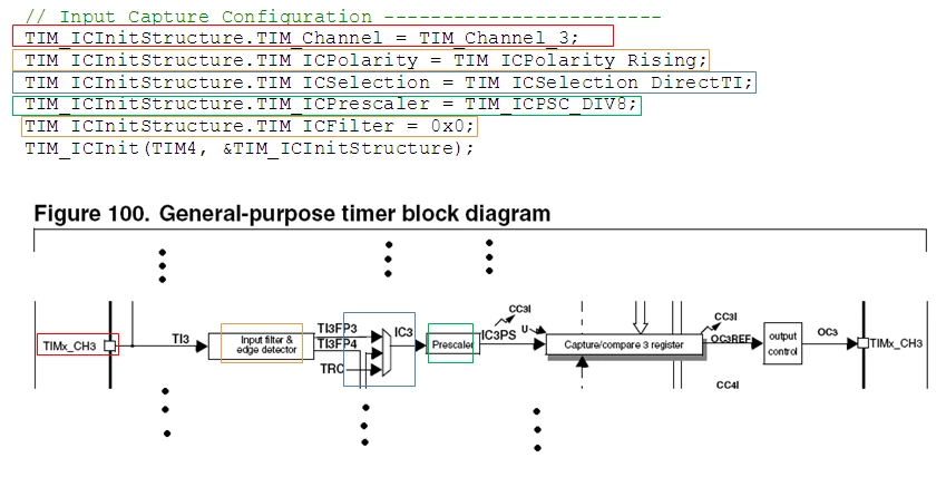

    I see exactly what you are talking about in Figure 100.  This basically means that there is a 'daisy chain' of configuration that has to be made in order to capture the transitions on TIM4_CH4.  It is the following:
    (1) TIM4_CH3
    (2) TI3
    (3) Input Filter/Edge Detector
    (4) IC3
    (5) Prescalar
    (6) IC3PS
    (7) Capture/Compare 4 Register
    The configuration for making IC3 = TI3 is set by ''TIM_ICInitStructure.TIM_ICSelection = TIM_ICSelection_DirectTI;''.
    For some reason when I configure TIM4_CH3 (TI3) to be selected as IC3 I cannot get my firmware to generate an interrupt and call ''TIM4_IRQHandler()''.  I am using Keil RL-RTX and the library provided by Keil in ''C:\Keil\ARM\RV31\LIB\ST\STM32F10x'', where the NVIC is configured for TIM4_IRQChannel (=0x1F in Keil Library).
    Is there anyway to troubleshoot why timer 4 is not generating an interrupt that calls the TIM4_IRQHandler() function?

    Look at Figure 100, All Densities Reference Manual RM008, Rev 10 to see the relationship between channels and capture compare registers.
    Cheers, Hal

    The corresponding configuration is the following:
