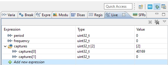

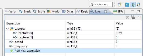

What I mean by getting no readings is shown in the following images.

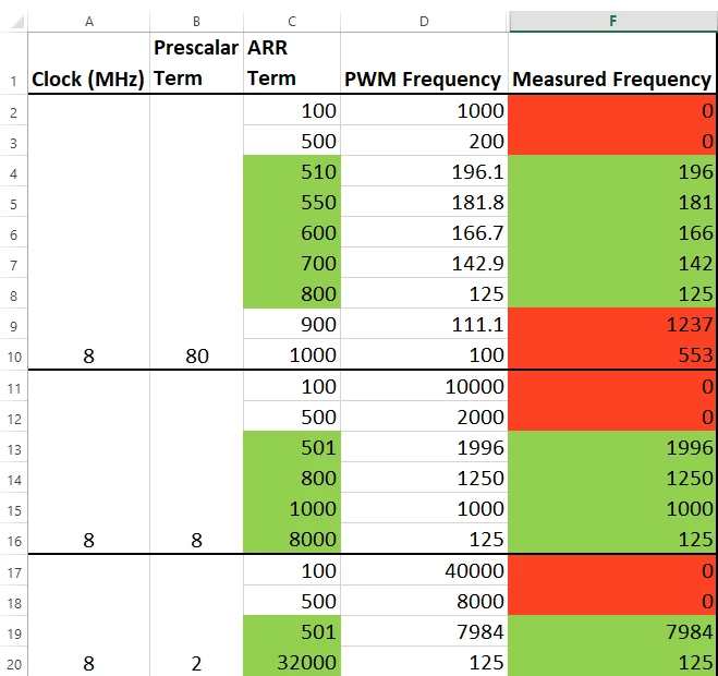

So I'm using a different timer on the board to output a PWM signal for my input capture pin to pick up. So if I set that timer to a prescalar value of 80-1, and an ARR value of 100-1, this should output a PWM signal with frequency 1000Hz, well above my minimum frequency. However, I pick up no values:
It looks like it captured one rising edge, but nothing after that.
Similarly, if I adjust the PWM signal to a prescalar of 80-1, and an ARR value of 500-1, that will output a frequency of 200Hz, still above the min frequency. However, I still pick up no values:

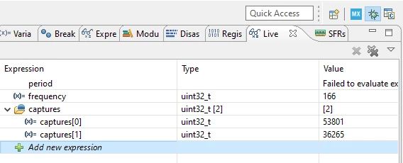

However, if I change the ARR value to be 600-1, while keeping the prescalar at 80-1, which is a PWM value of 166Hz then it actually does give me the correct frequency.
And it turns out this works as intended only for a small range between ARR values of 501 to 800, but everything else below 501 doesn't capture.
So here's where I get confused...if I change the prescalar from 80 to 8, then I can actually capture a frequency of 1000Hz correctly, but I'm still limited to a range between ARR values of 501 and 8000 this time. I made a table comparing all these different values.
Am I missing something here about how the STM32 is producing PWM signals? Does it have a limit on ARR values? My guess is that it actually does, and the limit is 500.
So if I turn up the clock speed, I bet this will work with higher PWM frequencies.
So then that begs another question, why is there this ARR limit?

March 19, 2020
The prescaler is 16 bits, so 65536 is not a valid value.
If it's 65535, then your timer tick rate is 8MHz / 65536 = 122Hz. So you can't capture anything faster than this. If you're trying to capture 1kHz signals, you'll want a much lower prescaler.
ARR has a 16-bit limit. It does not have a limit of 500.
I would suggest looking over the input capture section of the reference manual for a better understanding rather than changing ARR values and hoping for the best. Not the interaction between timer clock, prescaler, and auto-reload value.
Based on the code in your OP, you almost certainly want ARR = 65535.
BKoll.1
BKoll.1Author
March 19, 2020
Oh my table is referring to the PWM generation mode of a different pin. I don't seem to be able to generate a PWM wave faster than 48KHz.
As for the input captue, I did as you described for my input capture pin...its prescalar is 65535.
