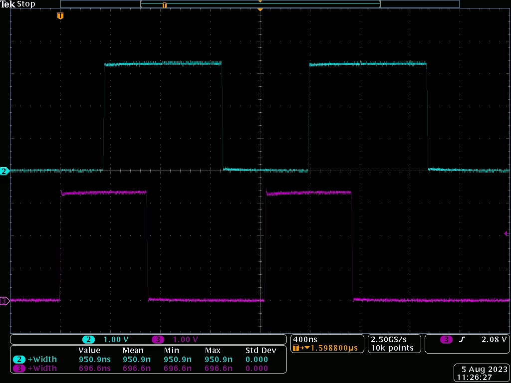

I am using the STM32F746VET6. I am aware that assembly instructions do not have a guaranteed in execution time, however I am surprised how consistently inconsistent my inline assembly macro is behaving. I'm really hoping there is just a mistake in the macro that I can fix. My IVT is in ITCM (memory address 0x0) and the ISR is also in ITCM (memory address 0x200). The 1st, 2nd, 4th, 5th, and 6th pin states show very close to the same delay every time. The 3rd and 7th pin states are always ~1.7x the others, however.
This is the macro:
#define nop_delay_def(delay_var) __asm volatile (".Lloop%=: \n\t" \
 " subs %[delay], #1 \n\t" \
 " bne.n .Lloop%= " \
 : [delay] "r" (delay_var))
And this is the ISR:
void __attribute__((optimize("O0"), section(".itcm_text"))) TIM1_TRG_COM_TIM11_IRQHandler(void) {
 PULSER1_GPIO_Port->ODR |= PULSER1_IN1_POS_Pin;
 nop_delay_def(60);
 PULSER1_GPIO_Port->ODR |= PULSER1_IN2_POS_Pin;
 nop_delay_def(60);
 PULSER1_GPIO_Port->ODR &= ~PULSER1_IN1_POS_Pin;
 nop_delay_def(60);
 PULSER1_GPIO_Port->ODR &= ~PULSER1_IN2_POS_Pin;
 nop_delay_def(60);
 nop_delay_def(60);
 nop_delay_def(60);
 nop_delay_def(60);
 HAL_IWDG_Refresh(&hiwdg); // kick the watch dog since FreeRTOS is suspended
 TIM11->SR = 0;
}// TIM1_TRG_COM_TIM11_IRQHandler
 I have attached a scope shot at the bottom. There is no jitter or variation in the pulses. They show that the macro is inconsistent consistently.

August 5, 2023
The Cortex-M7 core just doesn't make a guarantee you can use here. I don't see any issues with the macro. You could use DWT->CYCCNT to get within probably about 3 ticks of your target.

August 5, 2023
Thanks, I understood that there is no guarantee I just expected that to be a few ticks variation at worst rather than consistently 1.7x the execution time of the loop.Unfortunately my application needs to accurate down to one tick.
The obvious correct solution is to use an output compare instead of code to control the timing but that was complicated by the need to drive 15 pins in 7 states. We do think we may have come up with a solution to this using multiple timers and DMA but our board isn't currently laid out to use them.
The really frustrating thing is a previous version of code did test to have accurate timing down to one tick and we weren't even using an inline assembly macro at that time: we were calling an assembly function! It seems very small changes to the code result in very big changes in the timing, however, and we just got lucky with that previous version of code (for a whole year!).

waclawek.jan
August 6, 2023
Isn't there an overlooked obvious solution, i.e. a higher-priority interrupt prolonging the 3rd and 7th pulse?
If not, this is probably the price you pay for the performance. The CM7 is an overcomplicated beast, mildly superscalar, with features like speculative jump prefetch (with no public description of its algorithm). I'm not sure whether this grants the 1.7x time penalty, though; that's why the question above.
The asm version (i.e. a function called) has somewhat bigger chance to be consistent, as it sits always at the same address and uses the same registers.

RBack.1
RBack.1Author
August 8, 2023
Heh...you are correct that this is a problem I've been battling since taking over this code/PCB almost two years ago. It does show the problems when using the debugger or programming.
However, yesterday a young engineer in my company figured out the problem! He looked at the disassembly between the pulses that were regular and were irregular and the addresses that they occupied. By inserting nops to align them to 8byte boundaries he was able to make them all regular. Using a function instead of a macro (which we switched to from a function in hopes of making our problems better) he ensured that the code would always be aligned on the boundaries correctly, however calling the function with a parameter of 1 resulted in irregularity in the subsequent pulses. Now that we ensure that a minimum value of 2 is used for the function, our pulses are all regular again!
