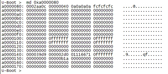

my register set around 0xa0000080 was below
and fmc clock was enable
but i still couldn't reset nand flash and read a error nand id as below

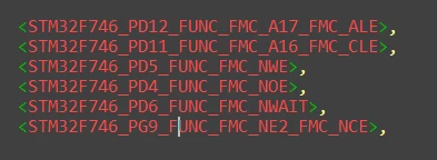

and my dts file relate fmc nand control pin as below
what's wrong maybe happen???besides these point,is there sth i couldn't get attention cause the problem???

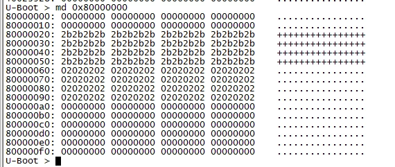

    After I compare my code with some others code,I found it's maybe i didn't set mpu config relate nand flash (address 0x80000000:256Mbytes).And after i add mpu config code,then it maybe right now.my mpu config as below
    now i could get nand id right,

    NAND acts more like a mass storage device than a random access memory, so dumping content is not going to be a good plan. There are only a handful of address pins connected to the NAND device, you are basically reading out of a FIFO, every read to the memory range returns a different value from the array.
    If you wanted to dump out a sector you'd need to memcpy() the whole thing in one step to a buffer, and then dump the buffer.
