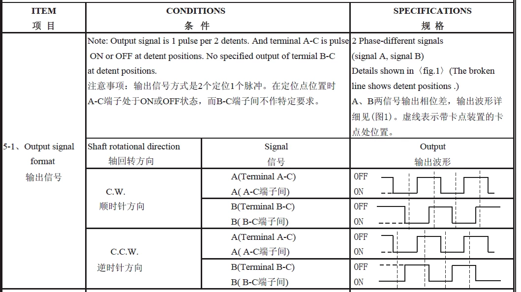

Following is a part of the encoder datasheet.
Thank you.

The reason the HAL_TIM_IC_CaptureCallback is fired every second turn is because the nature of the incremental encoder I have. The A & B signals go low every second turn and both IC1Polarity and IC2Polarity was set to TIM_ICPOLARITY_FALLING.
I have changed the sConfig.IC2Polarity  from  TIM_ICPOLARITY_FALLING to TIM_ICPOLARITY_RISING and now the HAL_TIM_IC_CaptureCallback is fired on each turn of the incremental encoder.

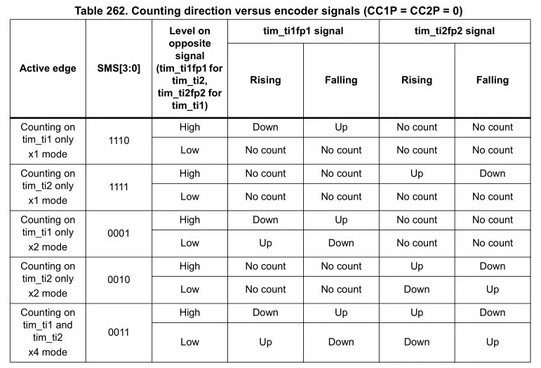

Did you try playing with the polarities for each channel? The reference manual has all the details, you should go through it.
This is from G4 RM but should apply
In the RM, this table is followed by two waveform diagrams, you should look at those.

waclawek.jan
Jul 1, 2024 11:28 AM UTC
You can change direction with setting polarity of *one* of the signals, i.e. setting one of the TIMx_CCER.CCxP bits.
I don't understand why would you want to have interrupts upon every edge; I don't think it's possible and I don't quite understand why would changing polarity change that. [EDIT] Re-reading your initial post, I now see you want one interrupt per *detent* - that might be possible if there are several (2 or 4) steps per *detent* and it may then depend on selected polarity. What I wrote about direction of counting above holds. You also can always reverse direction of rotation in software, simply by subtracting current TIMx_CNT value from (TIMx_ARR + 1).  [/EDIT]

Changing the direction of just one of the signals causes the HAL_TIM_IC_CaptureCallback  to triggere on every turn however  the direction is the opposite o want it to be.
I am using 0011 setting on SMS[3:0]

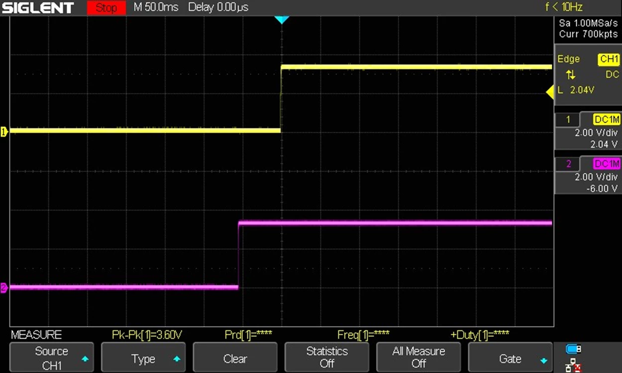

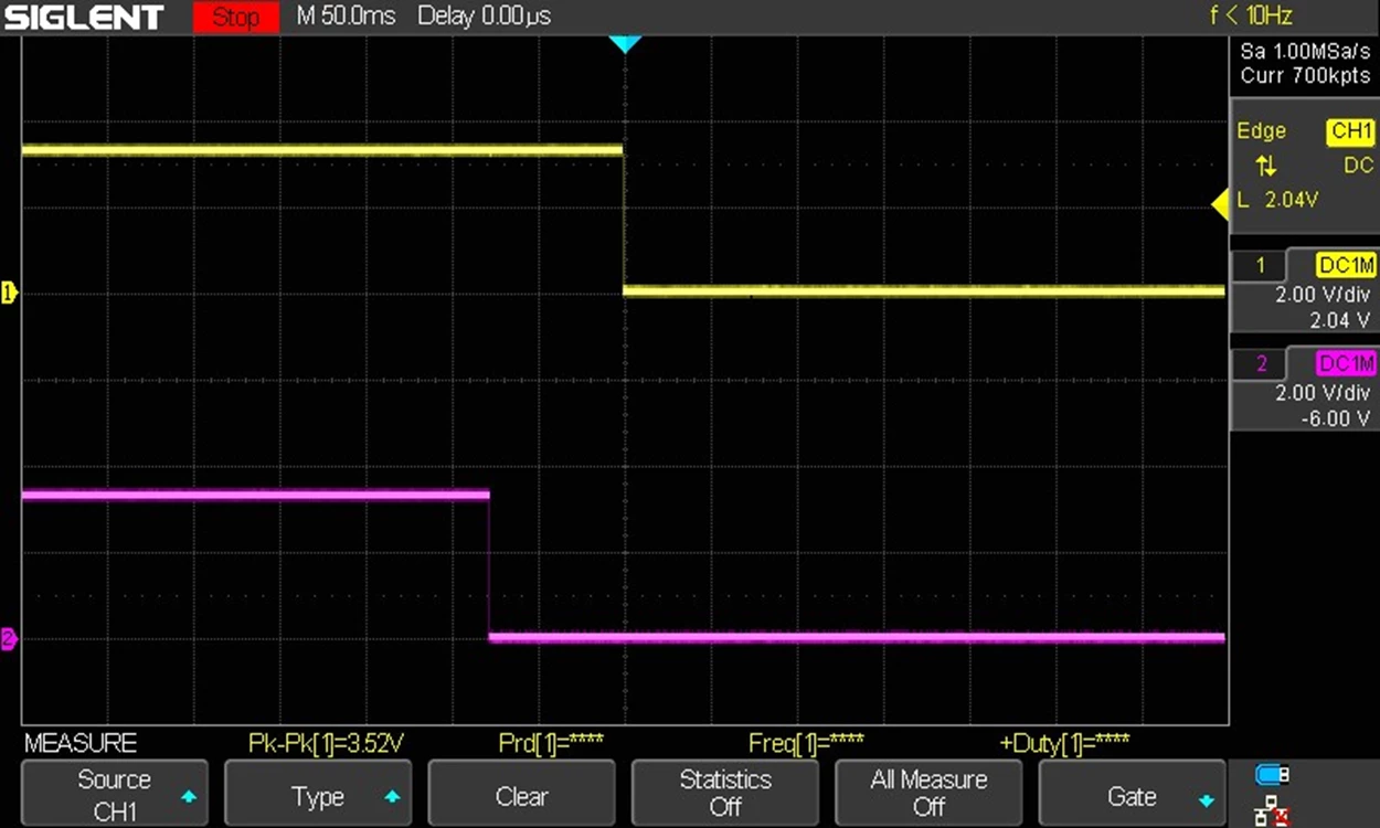

Kostas Papouis
Jul 2, 2024 9:36 AM UTC
Hi @BarryWhit ,
Following is a bit more info on what is happening:
You can see below on the oscilloscope the capture of the two signals where Encoder_A is on CH1 and Encoder_B is on CH2.
When Encoder_B signal goes low first the two counters are not the same. I believe this happens because the polarity of the Encoder_B on the firmware is set to rising but the signal goes low instead therefore missing 1 count within the interrupt. In the while loop the counter is updates correctly though.
On the other hand, when Encoder goes high first the two counters (in the interrupt and while loop)are the same:
The same behaviour occurs on the opposite direction.

BarryWhit
Lead
Jul 2, 2024 11:50 AM UTC
Right. So, you have two edges per counter tick.
Input Capture events normally (i.e. I expect that it does) triggers on a switch in logic level, not when the counter changes value.  So, if a pin toggles, but (due to polarity, turn direction, whatever) this edge is not what triggers the change to the counter value, when you read the counter value in the callback, it hasn't yet seen the other edge. When the other edge occurs, the counter updates, but there's no callback, because the 2nd edge does not trigger an Input Capture event. Does that make sense?
