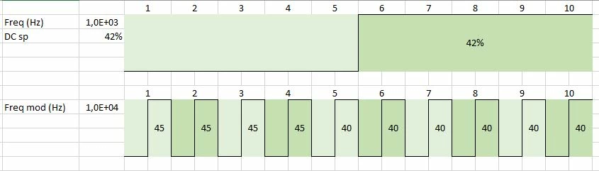

Related to use another TIM: I was looking for way to achieve a duty cycle in a 1% step even if configured for a 5% step. So the whole idea was to change my duty cycle in fractions of period, so the final average would be, for the example below, 42%.

The lower waveform is the output PWM going to the filter?
And the upper is the timer in which interrupt you modify the duty of lower one?
Which one is TIM1 and which one is TIM4?
Note, that the resulting waveform will have frequency components of not only the PWM "baseline" but also of the lower frequency "modulation". In other words, depending on the particular filter you use, you'll still "see" some of the modulation frequency on the output - maybe less than if you'd simply use a lower frequency PWM capable of the required resolution, but still being present. It depends on your application. how much this matters.
PWM is generally a cheap but inferior method of DAC. Use real DAC if you want a stable output with high resolution.
Maybe you should tell us what did you want to achieve at the first time.

The lower is TIM4 and upper is TIM1.
Actually, the upper waveform is my PWM output. Now the lower is where I modify the duty cycles (5% step) of the upper in little fractions so I can result in the desired duty cycle (of 1% step).
I want to develop a PWM module, with frequencies of 1Hz - 100kHz (step of 1Hz) and duty cycles of 1% step. But configuring my proc to this I obtain errors of more than 5kHz in the high frequencies, so I was looking for an alternative to decrease my error.
