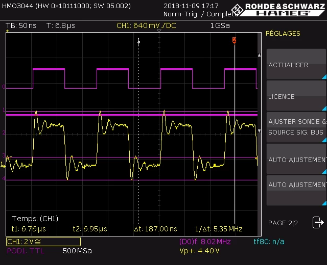

I'm trying to get data from an external ADC (18bits) with an STM32l476RG nucleo board. There is a lot of overhead and I will improve it later but even the frequency clock is not fast enough.
I don't understand why but the maximum clock frequency I get is 16Mhz (normally 40Mhz) and th signal is very durty. The systeme core clock is 80Mhz (trough the PLL and HSE) and the SPI prescaler is 2. I use cubeMx to configure the MCU:

    > the signal is very dirty
    What do you exactly mean by this? How do you observe the clock? If you use a LA or oscilloscope, do you have adequate bandwidth/sampling rate?
    Sirac
    SiracAuthor
    Nov 9, 2018 3:16 PM UTC
    There is a large overshoot on the falling and rising edge. I use an 350Mhz probe correctly calibrated and an 400Mhz oscilloscope. Please, see the picture.
    waclawek.jan
    Nov 9, 2018 8:32 PM UTC
    Try decreasing the GPIO drive (as set in GPIO_OSPEEDR).
    Ringing and overshoots are high-frequency artefacts on mismatched tracks/load. Note, that a few ns edge means significant frequency content well into the GHz region.
    Bob S
    Nov 9, 2018 9:31 PM UTC
    What @Community member​ said regarding drive strength. Though often that ringing you see on the scope is caused as much by a "long" ground lead on your scope probe as it is actual ringing (even with a 350MHz bandwidth probe, or SPECIALLY with a 350MHz probe).
    Also - your SystemClock_Config() sets the PLL parameters for a 32MHz clock from an 8MHz crystal. That is why you are getting a 16MHz SPI clock. Change to M=1, N=20 to get 80 MHz SYSCLK and 40MHz SPI clock

    Sirac
    SiracAuthor
    Nov 12, 2018 7:25 AM UTC
    Thank you for your answer.
    "32MHz clock from an 8MHz"
    The clock come from a 20Mhz crystal so I get 80Mhz.
    I'm agree with you and I'm not really surprised with the poo quality of the signal. What I don't understand is more about the frequency. I should get something very ugly but at 40Mhz. I know it's a lot but it's juste to set up correctly the SPI.
    I tried with the discovery board with the exact same config and I get a correct 40Mhz SPI clock but on this one no. I will try on an other pin to see what happen.

    I find the mistake:
    firstly RCC_ClkInitStruct.APB2CLKDivider was configured with RCC_HCLK_DIV2,
    and the hardware was configured with the 8Mhz of the stlink MCO and not with the crystal....
    So only my fault about this issue...
