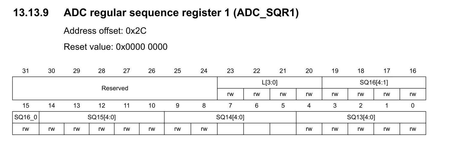

Here is what I found!
In my first code (not the one shared above), I set the rank/priority/sequence of Channel 16 to '1' using the ADC_SQR3 Register. And the temperature sensor worked perfectly fine!
But when I change the rank/priority/sequence to something that is NOT '1' (so 2, 3 or even 16), the temperature sensor does not work properly and I get garbage data in the ADC_DR (ADC Data Register). So the code shared above won't work because it sets the sequence of channel 16 to 16th sequence/rank/priority using ADC_SQR1 (see line number 33)
Why is this happening? Why does changing the rank/priority/sequence of channel 16 disturb the functioning of the code?
P.S. In the ADC_SQR1 there is a "bit-space" named "L[3:0]" (screenshot attached). I believe this bit-space stands for the "number of conversions you wish to make". This bit-space was set to 2 when I selected the rank/priority/sequence to be 2 and 16 when I made the priority 16. So I don't think the configuration of 'L' might be the issue. But please do let me know if my understanding is wrong.
P.P.S: Please let me know what is the correct technical term for rank/priority/sequence? I see different words used at different places. Some articles refer to it as rank, so as priorities and the reference manual refers to it as sequence.

Hi @AdityaUbarhande
In your case, you use ADC1 with only the Temperatur Sensor (internal channel 16).
So, you only have one conversion sequence, specifically the first ADC_SQR3 -> SQ1[4:0].
You do not need to configure the other sequences in ADC_SQR1 or ADC_SQR2 . Refer to RM0090 rev 21 in section 13.3.10 Discontinuous mode - Regular group.
I propose the following code which will allow you to convert the Temperature sensor in Regular mode, 1st sequence with a sampling time of 480 fADC cycles.
//ADC Configuration
*ADC_CR2 |= (1 << 10); // EOCS = 1: End of Regular conversion selection
*ADC_SMPR1 |= (7 << 18); // SMP16[2:0] = 0b111
*ADC_SQR3 |= (1 << 4); // SQ1|4:0] = 0b10000 Channel 16 is 1st conversion in regular sequence
*ADC_CCR |= (1 << 23); // TSVREFE = 1 Enable TSensor
*ADC_CR2 |= (1 << 0); // ADON = 1, ADC On
 while (1)
 *ADC_CR2 |= (1 << 30); // SWSTART Start conversion of regular channels
 while (!(*ADC_STAT & (1 << 1))); // Poll for ADC_SR EOC = 1
 uint16_t Vsense = (uint16_t)*ADC_DR; //Read ADC output data
 double voltage, celsius;
 voltage = (double)Vsense/4095*3.3;
 celsius = (double)(((voltage - 0.76) / 0.0025) + 25);
Let me know if it help you to better understand?
