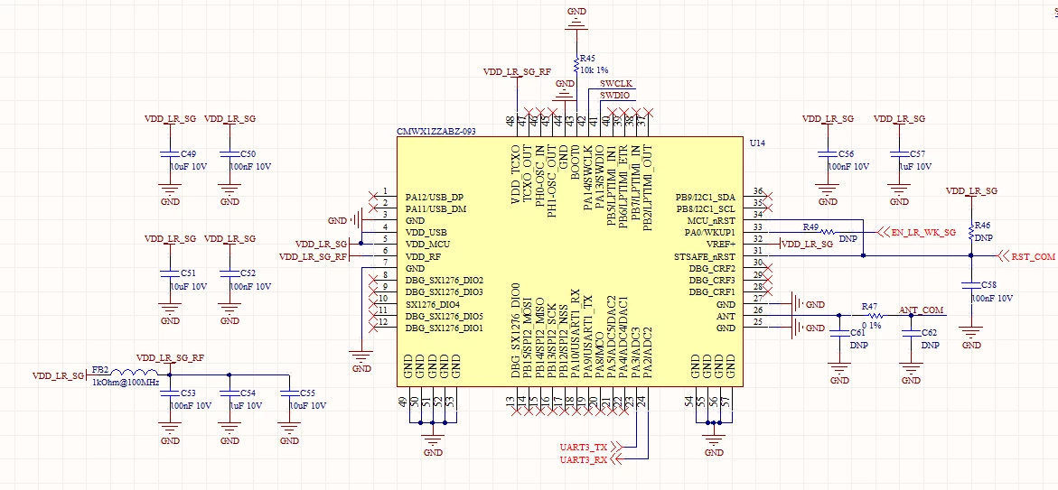

I design a LoRa aplication with CMWX1ZZABZ module. The schematic which I use is the following:
And the current consumption es 1.2mA. Anybody know which are the errors in the schematic to get 1.65uA of the datasheet of the module.

    Is this question related to STM32?
    Marcel Blindu
    June 22, 2018
    Posted on June 22, 2018 at 10:33
    Our application consists of a micro stm32f103 that communicates
    with lora module and we assumed that the module automatically
    enters into low power but the consumption of the module remains at 1.2mA
