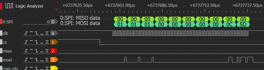

In my application, I'm using SPI (SPI1, a full feature set instance) with CRC enabled, on STM32H563ZI, with the configuration as:
I have a CRC implemented based on CCIT standard, which I call 'software CRC'
I see different CRC values for the same bytes of input from the micro and software CRC.

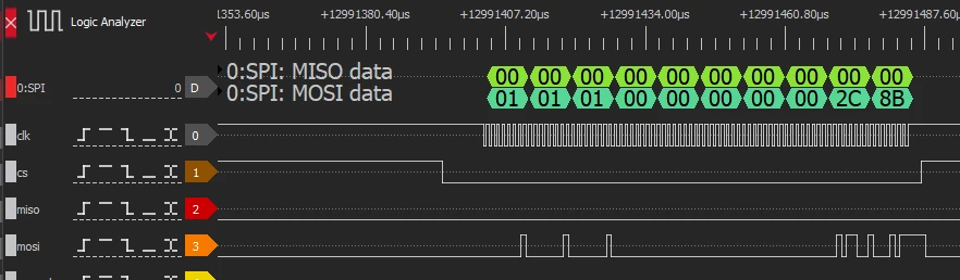

Fig1. Software CRC which is 0x8B2C (the last 2 bytes shown in Logic Analyzer, with msb first configuration)
Fig2: CRC from ST which is 0x5D0C for the same input.

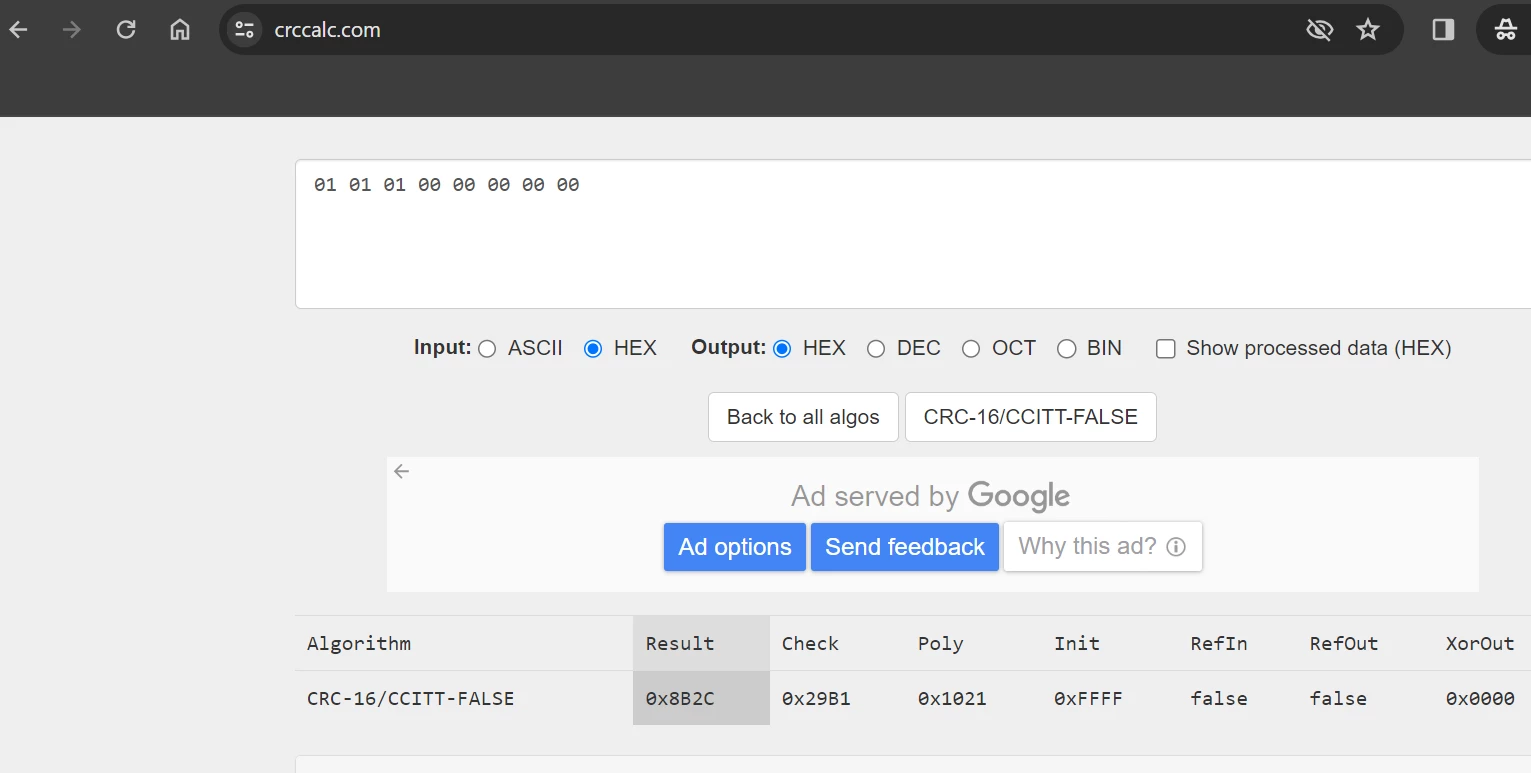

My software CRC calculation is not wrong and is verified using this calculator (https://crccalc.com/) which yields 0x8B2C.
Kindly help in understanding why the 'hardware' CRC is different from 'software'.

The CRC Polynomial for my software CRC calculation is 0x1021. However, in SPI CRC calculation I had to use 0x11021 to get the same result as software.

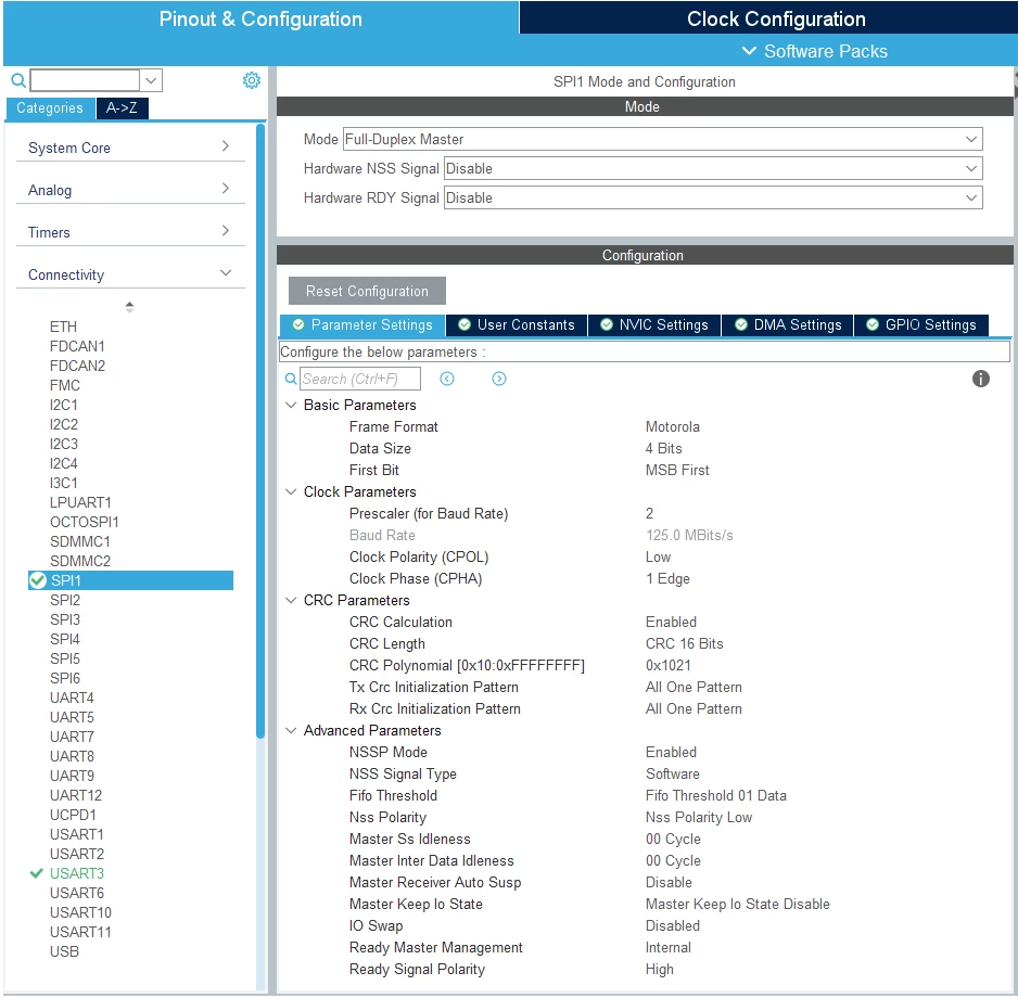

It's hard to analyze when the message is long. Try one byte first.
How exactly is SPI set up (post perhaps read out content of registers) and how exactly do you feed data to it?

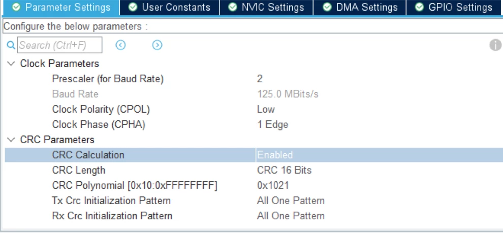

Apologies for the late reply. I could not get the registers content as I'm having trouble viewing the 'Registers Window' in Keil.
Here's my SPI configuration.

WCareyAuthorBest answer
April 23, 2024
waclawek.jan
April 23, 2024
This is surprising; although the description in RM may hint at it (that description is rather messy).
Thanks for coming back with the solution.
