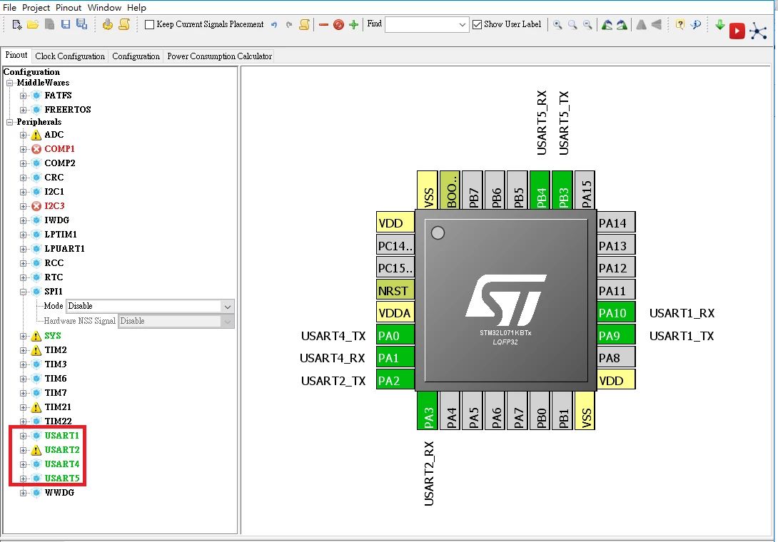

There is an inconsistent information about the numbers of usart in series STM32L071KBTx and STM32L071KZTx
(both LQFP32.)

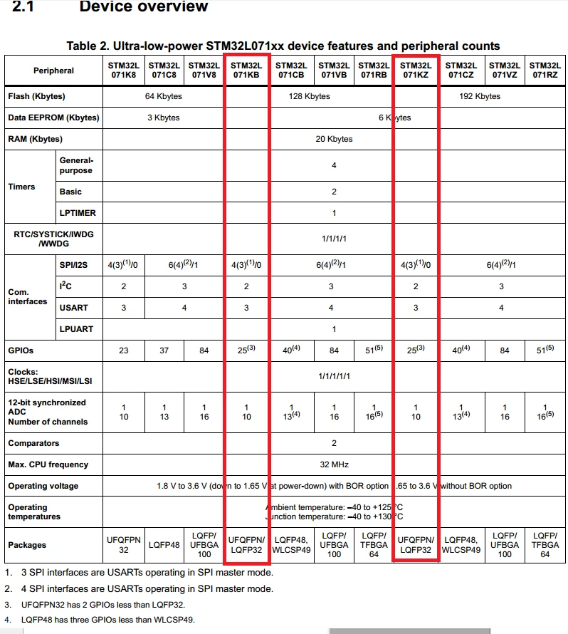

in the datasheet, it says there are 3 usart:
but in the STM32CubeMx, if I choose L071KBTx, I got 4 USART?!
Have I misunderstood something....?
There are totally 3 USART or 4 USART in this package??!!
I would like to know!
Thanks in advanced.

In the STMCU Finder pc software, if I choose STM32L0x1 and I request 4 USART,
then there will be no LQFP32 package in the result list.
However, If I use STM32CubeMx, doing the same (choose STM32L0x1 and 4 usart),
there will be STM32F071KB and STM32F071KZ in the result list.

For LQFP32 package, there are 4 USARTs available: you can check it based on pinout table.
However, if you use the UFQFPN32 package, only 3 USARTs can be used.
I agree with you that this has to be precised in the Table 2 of the datasheet.
I will check also for ST MCU Finder tool.
-Amel
