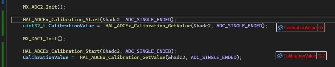

Hi.. Can anyone tell me why the ADC Calibration value is not the same before and after I initialize the DAC
It seems that the value maxes out if I calibrate after I have initialized the DAC.
The calibration register is 7 bits.
The ADC also measures incorrectly if I calibrate the ADC after I have initialized the DAC.
Anyone have a good explanation?

The problem is that MX_DAC1_Init() sets up the Clock again even though PeriphCommonClock_Config() has set it up correctly.
When MX_DAC1_Init() it sets it up to use RCC_ADCDACCLKSOURCE_HCLK and that's wrong!!!!
so it seems as if there is an error in cubeMX when using both ADC and DAC at the same time.
Can be solved by removing : HAL_RCCEx_PeriphCLKConfig() in HAL_DAC_MspInit();

I made some tests using STM32H563 and I'm getting the same calibration value before initializing DAC and after it.
I changed clock configurations without any impact.
I don't see clock set with RCC_ADCDACCLKSOURCE_HCLK  on DAC initialization.
At this level, may you:
  • make same check using another device?
  • share your IOC file to compare the configuration I used with yours?
