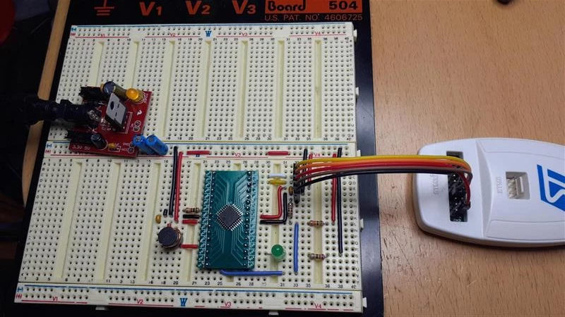

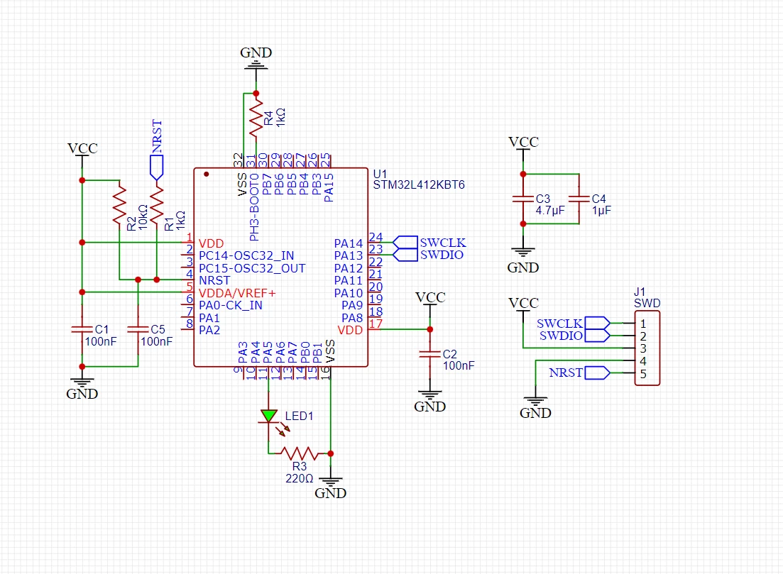

My setup consists of a very basic breakout PCB for the MCU:
Which is roughly hooked up as follows:

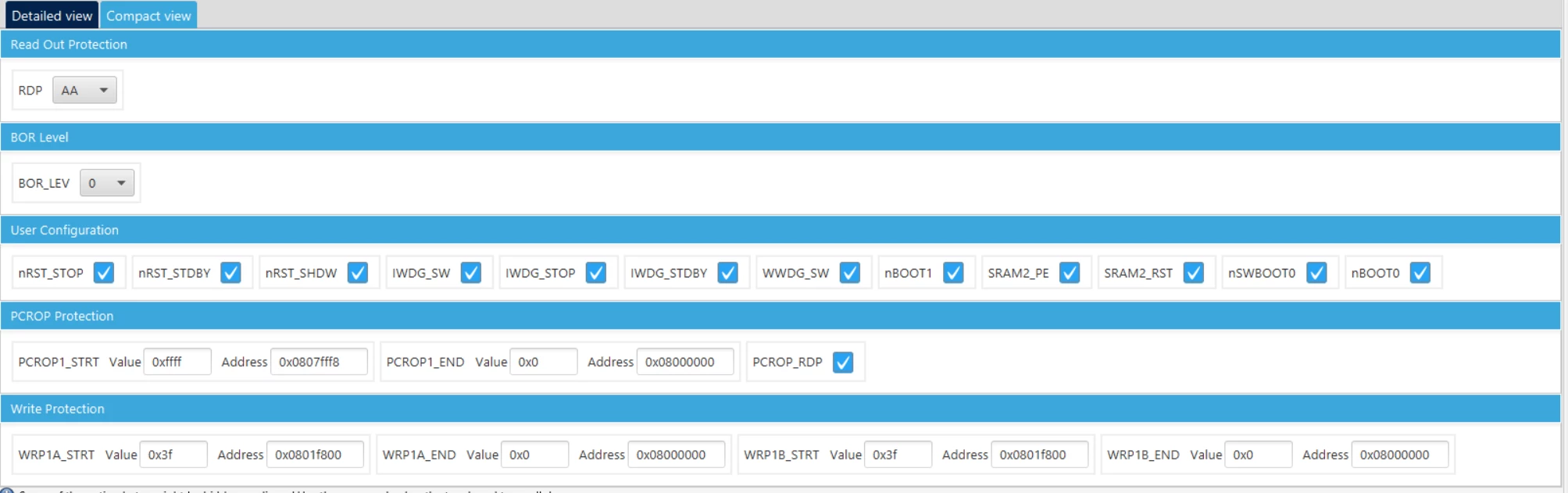

And the config flags in STM32CubeProg:
The issue:
The MCU doesn't boot directly into the user program when powered up. Only when I wait around 2-minutes after powering the board and then give the NRST-pin a low signal for reset, the user program starts executing. The program also sometimes starts executing after uploading the program through STLink, but resetting the board results in having to power it down and repeat the 2-minute wait method mentioned above. I've tried this with 3 MCU:s with identical results.

The loop Chip VDD/Pin1 via C1 to chip VSS Pin32 seems large. Insufficient decoupling may lead to inconsistant behaviour.
Better do your first experiments with Nucleo boards, as they have all the infrastructure needed.

Compared to the reference schematics in " Getting started with STM32L4 Series and STM32L4+ Series
hardware development" App. Note: NRST does not have a pull-up R. NRST is a bidir pin which is pulled down from inside on reset. You may monitor NRST level with a scope.

dear @JesFo
Indeed Reset circuit should be updated , please remove R1 and R2 resistors .

JesFoAuthor
May 26, 2025
Terribly sorry for the late reply. I've removed R1 and R2. Should I bridge NRST to high or low? Or should I leave it floating now that the resistors are removed?
Uwe Bonnes
Chief
May 26, 2025
NRST needs a capacitor for "temporization", so that everything is already set up when reset releases. The capacitor will also inhibit short noise pulses on NRST
JesFoAuthor
May 27, 2025
I have 100nF across NRST and ground.
KnarfB
May 27, 2025
And still inconsistent boot? Hard to diagnose remotely. Double check the power supply or replace it by a lab power supply or batteries/coin cell etc.. C1 C2 shall be close to the chip, you may solder them directly on the adaptor board.
The  STM32 Nucleo expansion board for power consumption measurement UM2243 User manual contains a chapter on how to prepare a Nucleo board for low power measurements.
