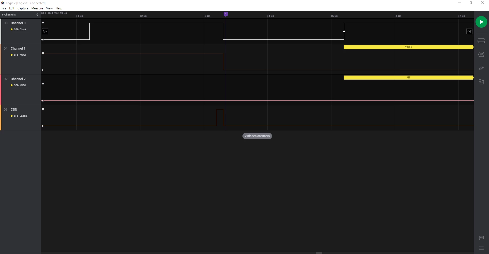

Zoom in to one of the messages so that individual clocks can be seen.
malehakim
malehakimAuthor
Jun 21, 2021 10:46 AM UTC

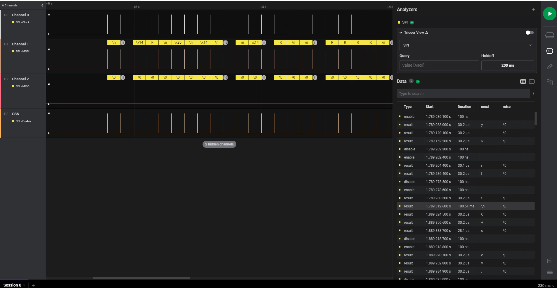

Snap view of the individual clocks generated when i send. Am expecting Hello World! in form of ascii but it seems to pick up dummy data that probably from other registers or the data is corrupted in some way
Jun 21, 2021 2:14 PM UTC
Looks like your CSN line is not behaving correctly. so your bytes are not synchronized to where they should be. I bet an analog capture of that line would show considerable noise, since there are 3 spikes that correspond with a negative edge on MOSI. Are you initializing it as output?
waclawek.jan
Jun 21, 2021 3:41 PM UTC
The transmitted characters as you show them are exactly those corresponding to Hello World!
48 65 6C 6C 6F 20 57 6F 72 6C 64 21
so it's just the LA which is not synchronized - if you set it to synchronize to CSN, then it's as TDK said - either incorrectly initialized pin, incorrectly connected (bad solder joint), or if it is a board with more circuitry on it, it conflicts with some other output.

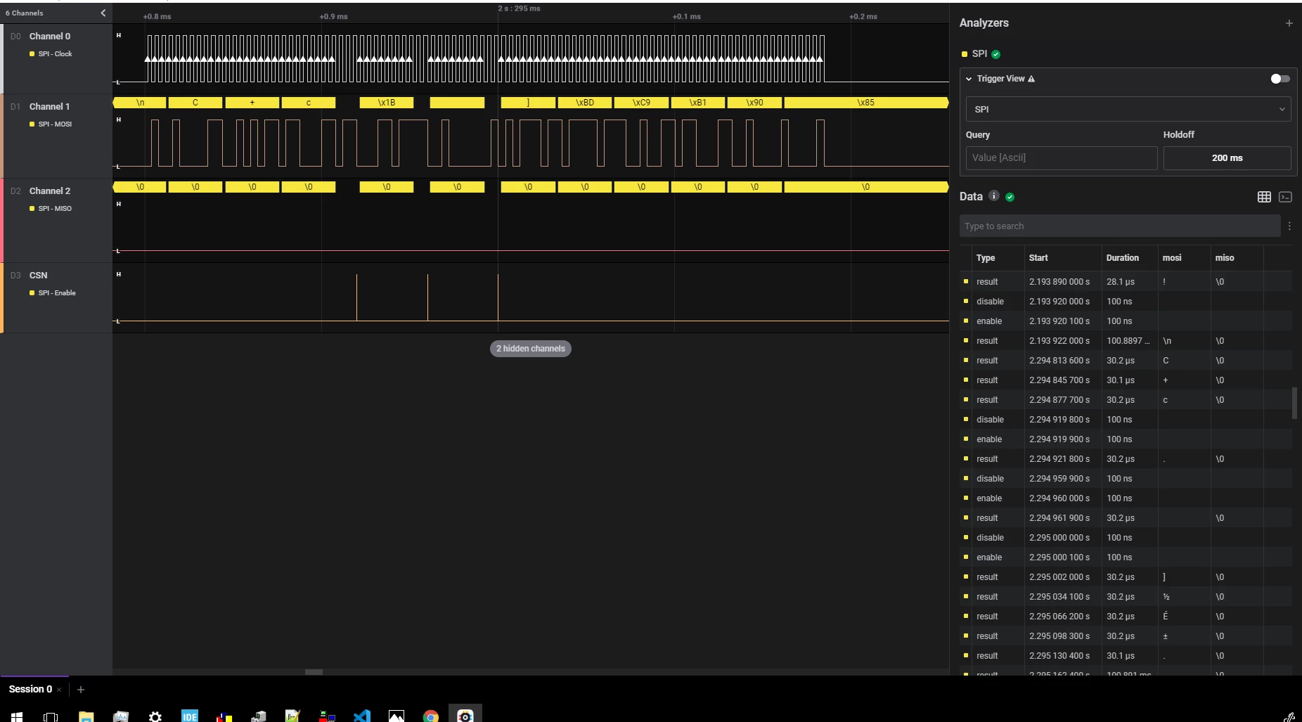

0693W00000BbiADQAZ.pngOk, thanks for all the replies. Am now starting to get it working. However, my CSN line is still not behaving well. It spikes up as shown in the snap above. One thing i've seen from all the tutorials is that they never initialize the CSN pin. Its always the MISO, MOSI, SCLK and the GPIO pins as alternate functions. I tried to initialize the GPIO where the CSN pin is so that i try with either pull-up or pull-down resistors but still not getting it right. How can i get a more consistent CSN link acting only to the right configuration.
Jun 22, 2021 5:47 PM UTC
CSN should be configured as a GPIO output pin and toggled manually before and after each transfer.
You appear to be toggling it with HAL_GPIO_WritePin, but not sure if you're initialized it correctly as you didn't include MX_GPIO_Init.

But still getting the glitch on the CSN line thats messing up all the data. It seems to happen when the clock is going down and MOSI is going low.....although this happens sometimes. Gash, thisz so frustrating. What on earth am i missing.
Jun 22, 2021 7:33 PM UTC
Should work. Remove the SPI part and just toggle PA4 until you get it working correctly. Double check connections. Make sure nothing else is competing for PA4.

malehakimAuthorBest answer
Jun 23, 2021 7:09 PM UTC
This was a tough but one but i finally got it solved. It turned out that my saleae logic devices' ground pin corresponding to the one connected to the CSN pin was not inserted in ground. So all i did was to insert it and the glitches on the CSN line disappeared like a fart i the wind
