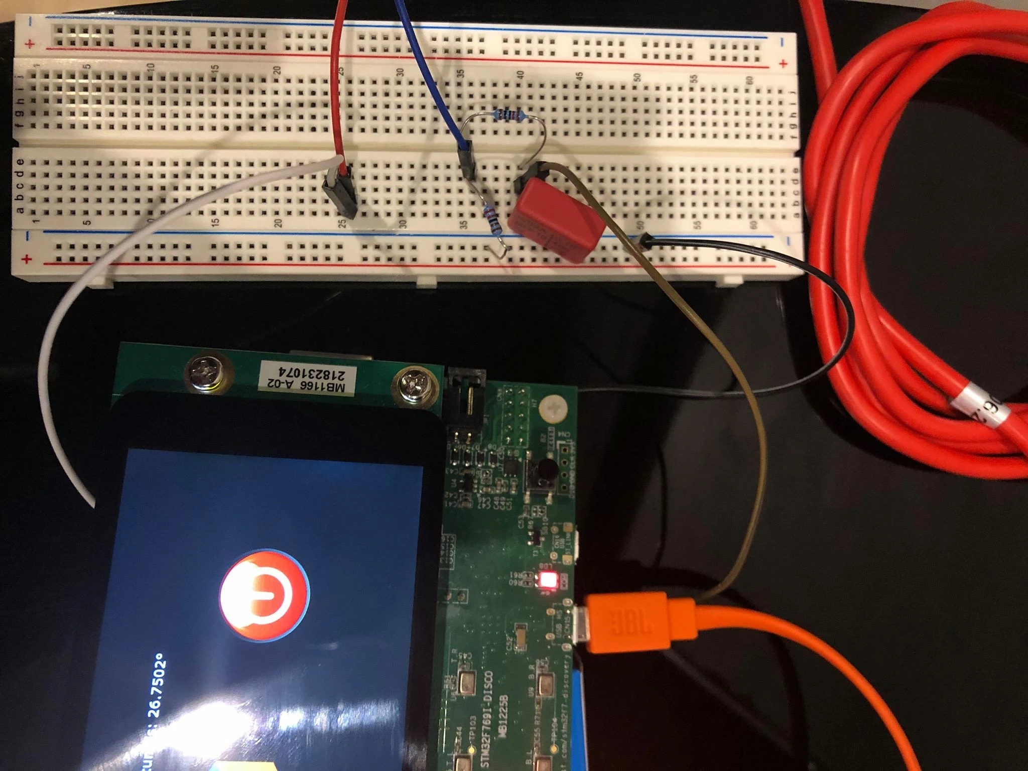

lyuIvanov
lyuIvanovAuthor
Mar 19, 2019 7:19 PM UTC
  1. Unfortunately, I don't have one :( should order
  2. I was unable to find a function that does it. However I watched how to do it in CR with ADC_CR_ADCAL, but the problem is that TouchGFX shows compilation error while using registers.
  3. I have checked and it seems that the pins to the Arduino looking rail are only connected to the rail itself.
  4. I have tried connecting 1.5V battery, but still flickering a lot. When wire going to ADC is removed, it continues to show values. When wire is connected directly to ground receive fluctoations between 0-45, maybe a bit more. When connect directly to ref voltage (IOREF5) shows 4040-4095. When it is wired all as the pic I'm posting in next comment, it shows 2680-2750 at room temp.
  5. For the testing In order to write this response I have setted the Delay at 100, which is 10 times a second. I'm using ADC_CLOCKPRESCALER_PCLK_DIV4 and sampling time of 480.
In the end I see, that the error has become smaller, but still bigger than desired. Maybe I can shorten somehow the range, since I'm not going to read temps below -10 and above 180 degrees. So I will have 4095 across 190 points, instead of 600 or more hundreds. The problem though is that I have no idea how to do it and if it will improve accuracy. It is logically to do so, but who knows...
P.s I don't think that current is high, since overnight it showed the same values in the morning as midnight. I have measured it with multimeter, it showed 1000uA, but I don't know if it is that accurate and thrustful.
lyuIvanov
lyuIvanovAuthor
Mar 19, 2019 7:28 PM UTC
0690X0000088Gz3QAE.jpg1. White wire is Vref (3.3V)
2 Red wire is one end of thermistor (connected to white wire)
3 Blue wire is other end of thermistor
4 Resistor going to ground is 2k2Ohm (connected to blue)
5 Resistor going to brown is 10kOhm (connected to blue)
6 Brown wire is going to ADC
7 Capacitor is 150nF ceramic going to ground as well (connected to brown)
8 Black wire is connected to ground pin
