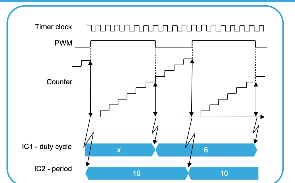

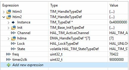

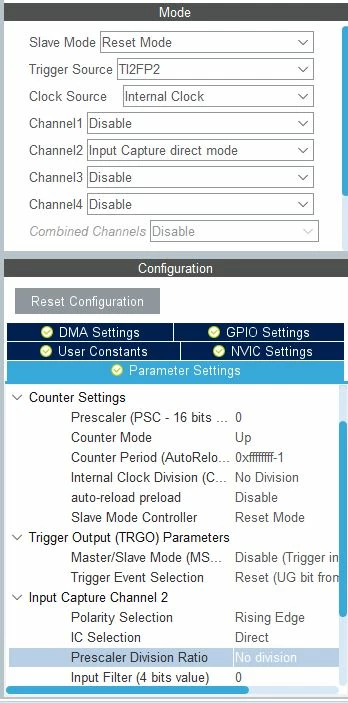

I am trying to implement a frequency counter using an STM32F446 and STM32CubeIDE. I am following the reciprocal measurement approach of one STM32 tutorial available in internet (see screenshot). Basically, i am using the input capture mode to save the CNT value of the first rising edge. I would like to measure in the range of 50-100Khz but my results are not accurate enough.

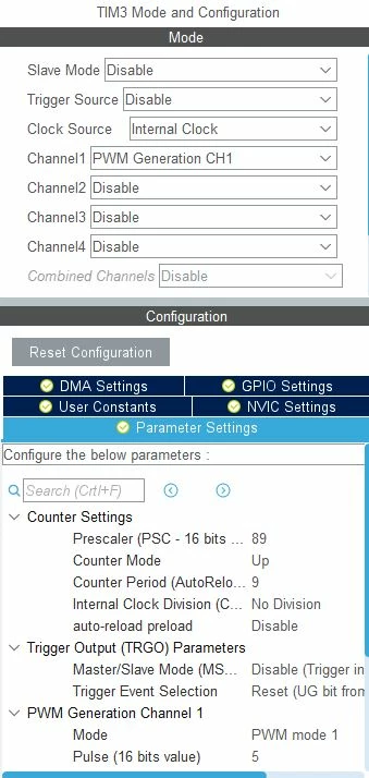

I am generating the PWM signal to be measured also with the same STM board using the PWM output of timer 3. The generated signal seems to be good enough, I have checked it with an Nscope USB oscilloscope. It only has a few noisy edges that might have been caused by the cables that I am using (single stand wires). Could this be the main problem?

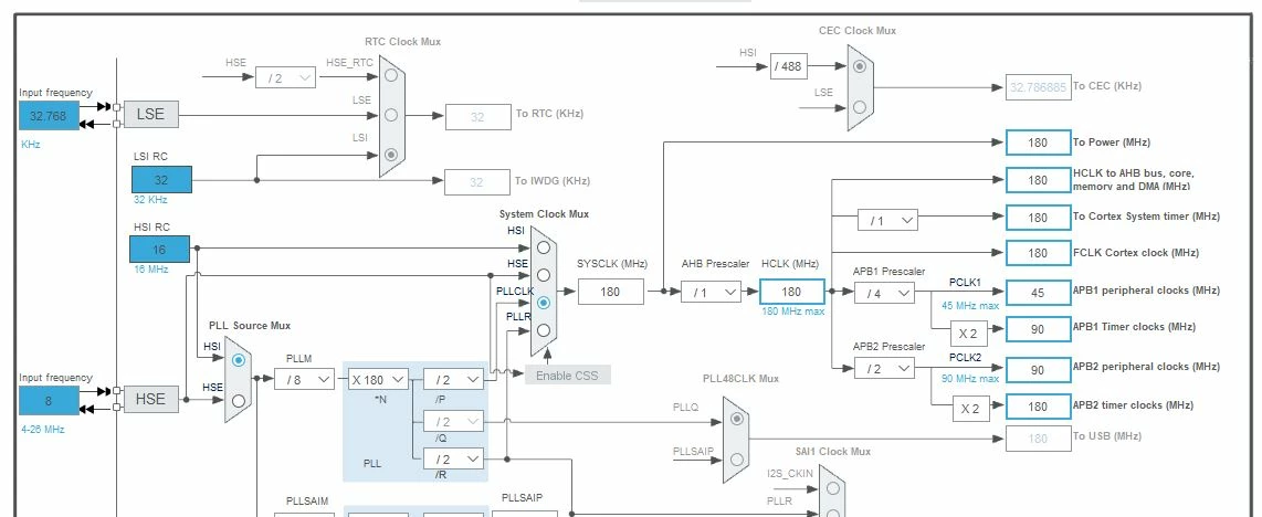

timer2clk=HAL_RCC_GetPCLK1Freq()*2/ (htim->Init.Prescaler + 1);// timer_clock is modified by the prescaler of the timer
freq=(timer2clk)/val2;

HAL_TIM_Base_Start(&htim3);
HAL_TIM_PWM_Start(&htim3, TIM_CHANNEL_1);
//freqdesired=timerclock/(prescalar+1*period+1)
timer3clk= HAL_RCC_GetPCLK1Freq()*2;
period=htim3.Instance->ARR+1;
calculated_psc = ((timer3clk)/(set_freq*period))-1;
htim3.Instance->PSC=calculated_psc;
//init timer for PWM measure
HAL_TIM_Base_Start(&htim2);
HAL_TIM_IC_Start_IT(&htim2, TIM_CHANNEL_2);
