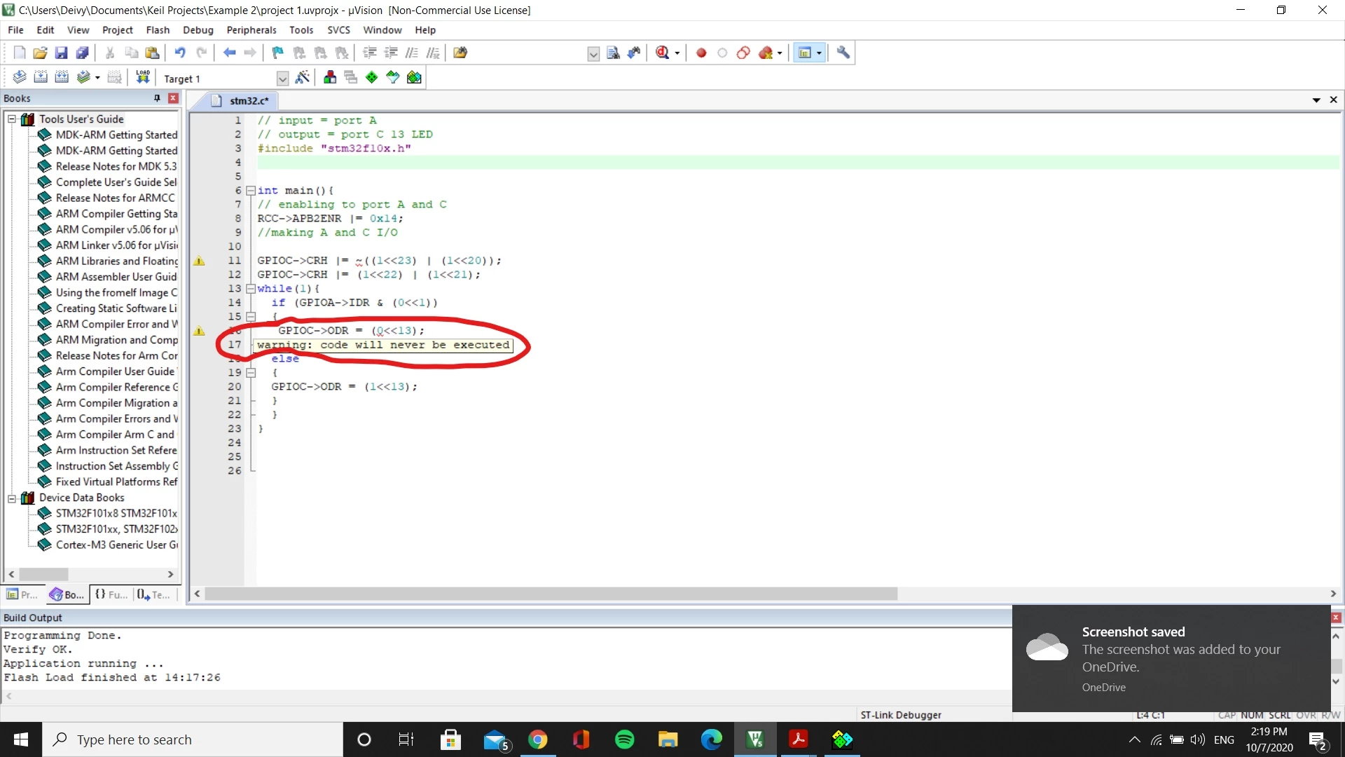

Inability to read 0 value from INPUT.
I was trying to program STM32 to read the values and toggle the LED, but it didn't work. Please help

You use bitwise and with a bitmask of 0, so the result = 0. (0&0) = 0 = false.

(0 << 1) evaluates to 0 and if (0) never executes!

Sorry I didnt fully understood, can you explain more ?

if (GPIOA->IDR & (0 << 1)) will never get true!

if IDR is all 0's and its ANDed with 0 , how will it never be true? for example , IDR = 0 and 1st bit = 0 (0&0) = True = 1

lol , thanks, that makes sense
the 0&0=1 was an oopsie

You also probably don't want to blind write into the entire ODR, as it will impact all bits. Use BSRR for such writes
GPIOC->ODR |= (1 << 13); // set PC13
GPIOC->ODR &= ~(1 << 13); // reset PC13 (uses tilde, stupid forum prints as minus)
