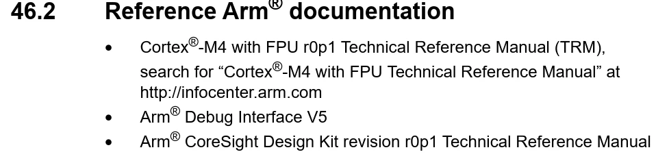

the debug is part of the Arm Cortex-M4 core, so look at arm :
https://developer.arm.com/documentation/100166/0001/Debug/Debug-configuration/Debug-register-summary?lang=en
>> Debug registers are described in the Armv7-M Architectural Reference Manual.
in RM :

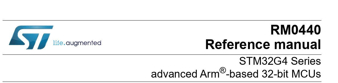

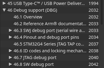

What exact document is the screenshot from? The Armv7-M Architectural Reference Manual looks different. In my RM0440 chapter 46 is USB related.

screenshot from:
STM32G4-serie-manual
0693W00000WLc8PQAT.png0693W00000WLcDhQAL.pngRM0440 rev.2 .
Nickelgrass
Senior
December 22, 2022
Ah ok. I got rev3.
