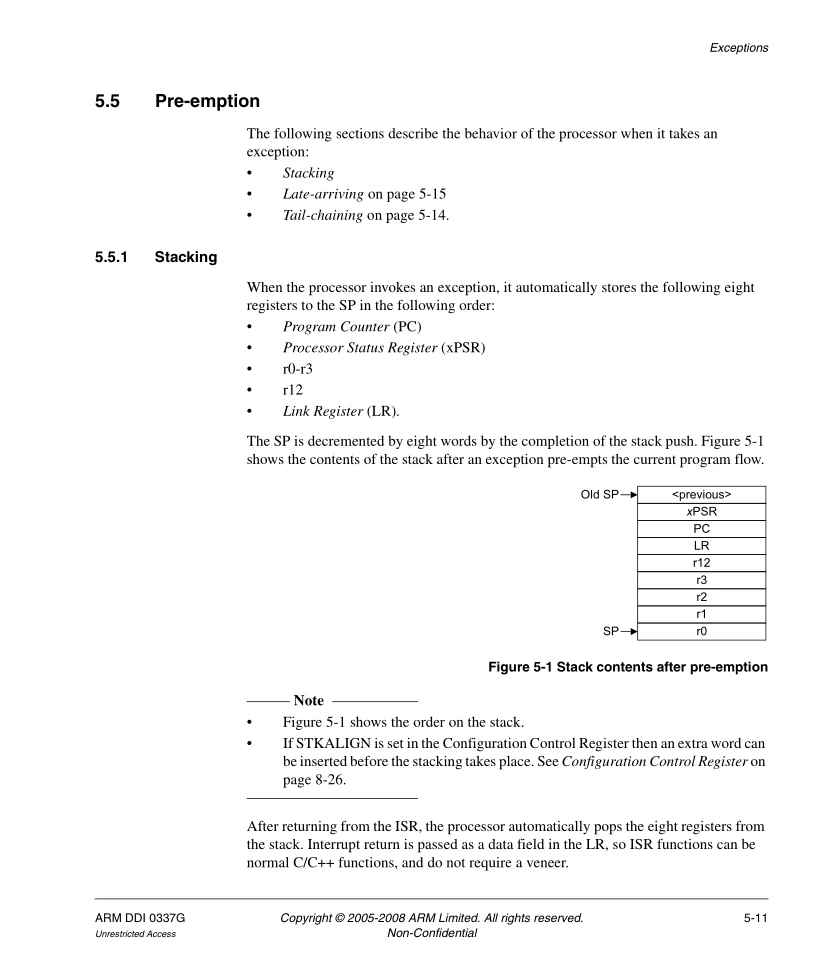

In what order are registers pushed into the stack after the exception occurs?
  • November 21, 2017
  • 4 replies
  • 886 views
Posted on November 21, 2017 at 19:24
In Cortex M3, what is the order in which the register are pushed into the stack?
Which of the following orders are correct (if any)?
First Order:
      PC
      PSRx
      R3
      R2
      R1
      R0
      R12
      Link Register
Second Order:
      PC
      PSRx
      R0
      R1
      R2
      R3
      R12
      Link Register
Please Guide? Thanks in advance?

Posted on November 21, 2017 at 20:03
Where
R0 = [SP + 0]
R1 = [SP + 4]
etc

Posted on November 21, 2017 at 20:12
void hard_fault_handler_c(unsigned int * hardfault_args, unsigned int r4, unsigned int r5, unsigned int r6)
  printf ('\n[Hard Fault]\n'); // After Joseph Yiu
  printf ('r0 = %08X, r1 = %08X, r2 = %08X, r3 = %08X\n',
    hardfault_args[0], hardfault_args[1], hardfault_args[2], hardfault_args[3]);
  printf ('r4 = %08X, r5 = %08X, r6 = %08X, sp = %08X\n',
    r4, r5, r6, (unsigned int)&hardfault_args[8]);
  printf ('r12= %08X, lr = %08X, pc = %08X, psr= %08X\n',
    hardfault_args[4], hardfault_args[5], hardfault_args[6], hardfault_args[7]);
