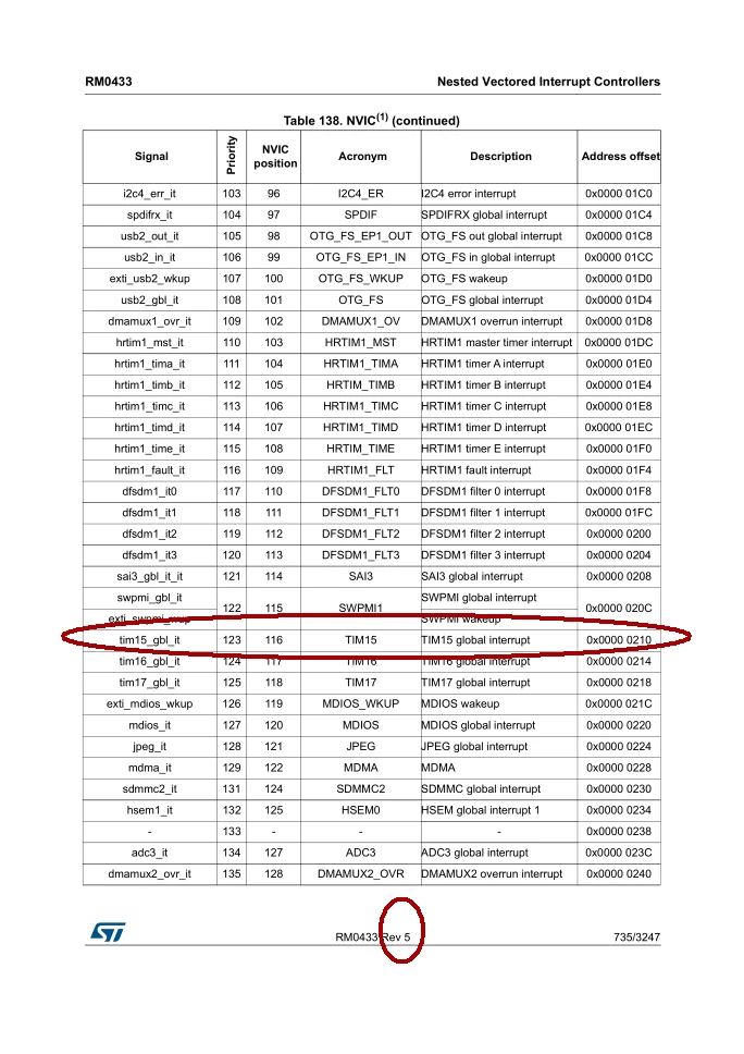

In the reference manual for STM32H7 interrupt with NVIC position 123 is missing. What is the interrupt?
Reference manual for STM32H7 series (RM0433), on page 697, does not show an entry for NVIC interrupt 123.
What is the interrupt? Can the documentation be fixed by the team.
Interrupts that are not triggered by the MCU are normally marked with a line across the row.
Current errata document (June 2018 ES0396 Rev 4) does not have information about it.
