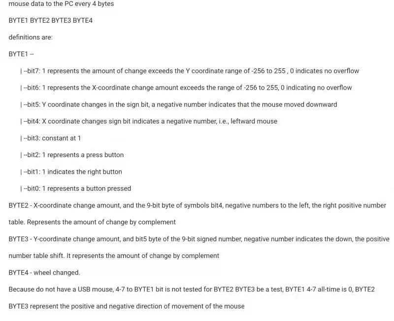

In the official example(Ux_Device_HID_CDC_ACM), HID device as mouse ,how to send right or left key to pc?
In the official example(Ux_Device_HID_CDC_ACM),HID devices as mouse
/* Mouse event. Length is fixed to . */
 hid_event->ux_device_class_hid_event_length = 3;
 /* Set X position. */
 hid_event->ux_device_class_hid_event_buffer[0] = x;
 /* Set Y position. */
 hid_event->ux_device_class_hid_event_buffer[1] = y;
 hid_event->ux_device_class_hid_event_buffer[2] = 0;
/* Send an event to the hid */
 ux_device_class_hid_event_set(hid, &hid_event);
but i want send key(right key or left key) to pc.
so i view google
0693W00000Hq8yLQAR.jpgFollow the above method,i Modified code
this is
 hid_event->ux_device_class_hid_event_length = 4;
 hid_event->ux_device_class_hid_event_buffer[0] = 2;
 hid_event->ux_device_class_hid_event_buffer[1] = x;
 hid_event->ux_device_class_hid_event_buffer[2] = y;
 hid_event->ux_device_class_hid_event_buffer[3] = 0x00;
i tested,finded not send key to pc.
so i ask how to do send a right or left key to pc?​

    hello!
    The problem is that hid_mouse->ux_device_class_hid_report_id is setted to UX_TRUE (i don't known why).
    That flag it as to be used if you have a report descriptor with more the one ID so the library attach at the front of the data array the byte hid_event->ux_device_class_hid_event_report_id
    in your case you  have a report descriptor with a unic ID (actually without an ID)
    your interpretations of the buffer are correct:
    hid_event->ux_device_class_hid_event_buffer[0]  ---> buttons
    hid_event->ux_device_class_hid_event_buffer[1]  ---> X
    hid_event->ux_device_class_hid_event_buffer[2]  ---> Y
    hid_event->ux_device_class_hid_event_buffer[3]  ---> wheel
    BUT with the flag setted to UX_TRUE the actual buffer become:
    hid_event->ux_device_class_hid_event_buffer[0]  ---> hid_event->ux_device_class_hid_event_report_id (that is 0)
    hid_event->ux_device_class_hid_event_buffer[1]  ---> buttons
    hid_event->ux_device_class_hid_event_buffer[2]  ---> X
    hid_event->ux_device_class_hid_event_buffer[3]  ---> Y
    hid_event->ux_device_class_hid_event_buffer[4]  ---> wheel
    in the example  the buttons are always 0
    to fix that before ux_device_class_hid_event_set(hid_mouse, &hid_event);
    make sure to:
    hid_mouse->ux_device_class_hid_report_id = UX_FALSE;
    so the hid_event->ux_device_class_hid_event_buffer[0] become actually the first byte sended
