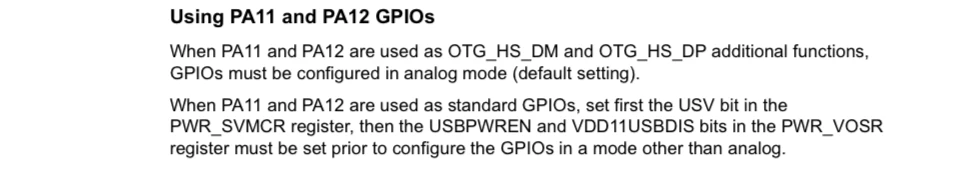

I have configured PA11 and PA12 pins in input mode, but they are not responding — I’m continuously getting a low level from the MCU side.
For testing purposes, I configured the same pins as output, and they work fine in output mode.
To verify hardware, I removed the MCU and checked the lines — they remain high, confirming that the hardware is OK.
Please suggest the possible reason or solution at the earliest.
Best answer by Issamos
Hello @Dharmendra_Singh
I think what is special for the PA11 and PA12 of theSTM32U5G7 is mentioned on the paragraph 10.7.12 of the RM0456:
  • PA11 and PA12 are used as standard GPIOs, set first the USV bit in the PWR_SVMCR register, then the USBPWREN and VDD11USBDIS bits in the PWR_VOSR register must be set prior to configure the GPIOs in a mode other than analog.
Same behavior reported and solved here.
Best Reagrds.
Best Reagrds.
II
October 29, 2025
Big Thanks, Working fine ....
