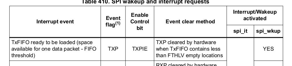

In stm32h743, is the TXP interrupt fired endlessly until the Tx FIFO is full?
  • March 22, 2023
  • 3 replies
  • 2939 views
I'm trying to debug a problem by which, if the EOT IRQ is enabled, an SPI slave enters an endless loop of ISR executions. I suspect it might be related with how IRQs are generated.
According to the H7 user manual:
The TXP interrupt is generated whenever there is space available in the TxFIFO. Does this mean that the above IRQ will fire endlessly if the Tx FIFO is never filled? In other words, if the above IRQ fires but the corresponding ISR doesn't even write to the TxFIFO, will it fire again immediately after the current ISR returns?
Also, is there any problem in enabling interrupts before filling the TxFIFO?

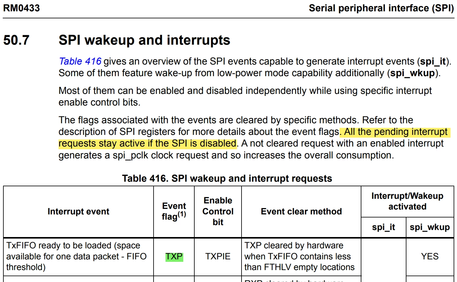

Hello @DGast.1​,
Yes, if the TXP interrupt is enabled (ready) and the Tx FIFO is not being filled by the corresponding ISR, the interrupt will continue to fire indefinitely as long as there is space available and not used in the Tx FIFO. Also, enabling interrupts before filling the TxFIFO should not cause any problems as long as the interrupt priorities and ISR handling are properly configured.
As mentioned in the description, all the pending interrupt requests stay active if the SPI is disabled.
0693W00000aJZMTQA4.pngHope it helps.
To give better visibility on the answered topics, please click on "Best answer" on the reply which solved your issue or answered your question.Best regards,FBL
