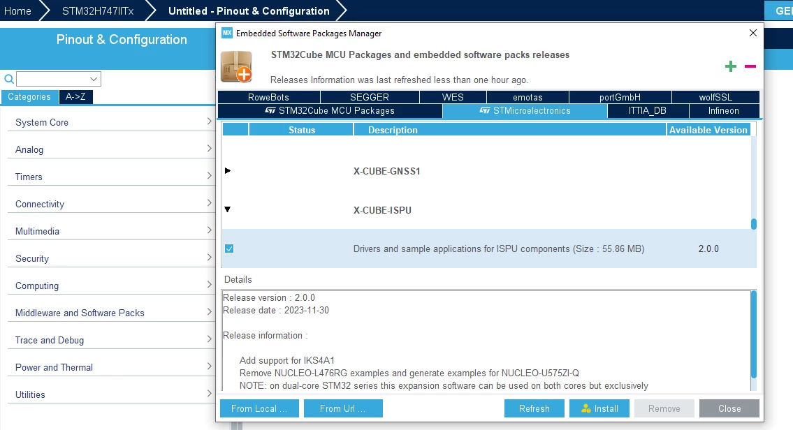

I installed it twice in Windows 10 from the zip file I downloaded from the ST website and then once with GitHub, but still no joy.
All the other apps show up as Ok by the Validator.
I'm going to proceed with the workshop but if you can shed some light on why I'm getting this message, I'd appreciate it.
Regarding my configuration, I've install the executables in "f:\usr" vs "c:\program files" and the data in g:\wss" vs.  "c:" drives.

Hello @pinaar ,
Did you try installation using STM32CubeMx?
From the "Embedded Software Packages Manager" window, press the [Refresh] button to get an updated list of add-on packs. Go to [STMicroelectronics] Tab, and select the [X-CUBE-ISPU] package version you wish to install and click the [Install] button.

Thank you so much. I just installed STM32CubeMx and installed the X-CUBE-ISPU from the "Embedded Software Packages Manager". Since the workshop is on MEMS with ISPU Core, I also installed the MEMS1 Software Package.
