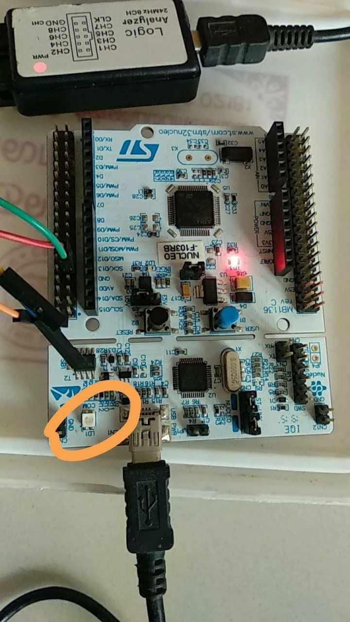

In my Nucleo while debugging STLINK LD1(RED and GREEN) is not blinking
In my Nucleo while debugging STLINK LD1(RED and GREEN) is not blinking. I study with some of documents. it is communication error, But the debugging is is normal
Please tell me what is the problem ? Any settings to change ?
I have attached the photo. Now nucleo is debugging mode

So st-link programming and debugging works okay but just the LED is unlit? Could probe the led to ensure it actually works. But I wouldn't spend time on it. There must be more important things to do.

Ok, But it seems communication error I think. Ok how to flash my nucleo with stm32cubeide without debugging ?

Try updating ST-LINK firmware to current.​
Can it run Cube Programmer?​

No I did't tried yet. But I would like to stay inside only cubeide. I want to learn all the things this cubeide. It is good for me. I wont migrate from cubeide.
Because already switched form KEIL(without proper use). At least I would like to learn all the things using this cubeide.
