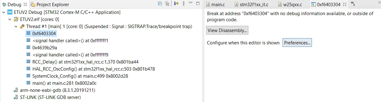

Program flow reach to main () function. System break during system clock configuration. I did not do any change for system clock. Program flow go as follow.
SystemClock_Config -> HAL_RCC_OscConfig -> RCC_Delay(1);
In RCC_Delay function, system break. Please see attachment. I attached picture of break from IDE.

waclawek.jan
June 21, 2023
From this description it's hard to judge where's the problem. It may be RCC_Delay() (? look into that function) or it may be any interrupt - check if VTOR is set properly and if you have the proper interrupt table. Alternatively try to disable all interrupts as a test.
