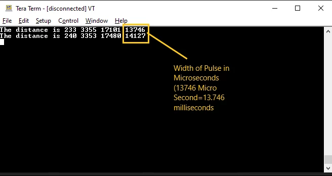

In input capture function , i am trying to interface HC-sr04 Ultrasonic sensor to STM32F401. I am giving input to TRIG pin with 10 micro seconds ON and Need to Measure Pulse from ECHO pin of the Sensor and not getting Exact Width.
The Pulse width value of the waveform in input capture is not matching with orginal Pulse from sensor output .
Please help.

TIMx_PSC is preloaded, you need to force update by setting TIMx_EGR.UG to get it "active".

Thank you again JW.
Now Project is working perfectly
