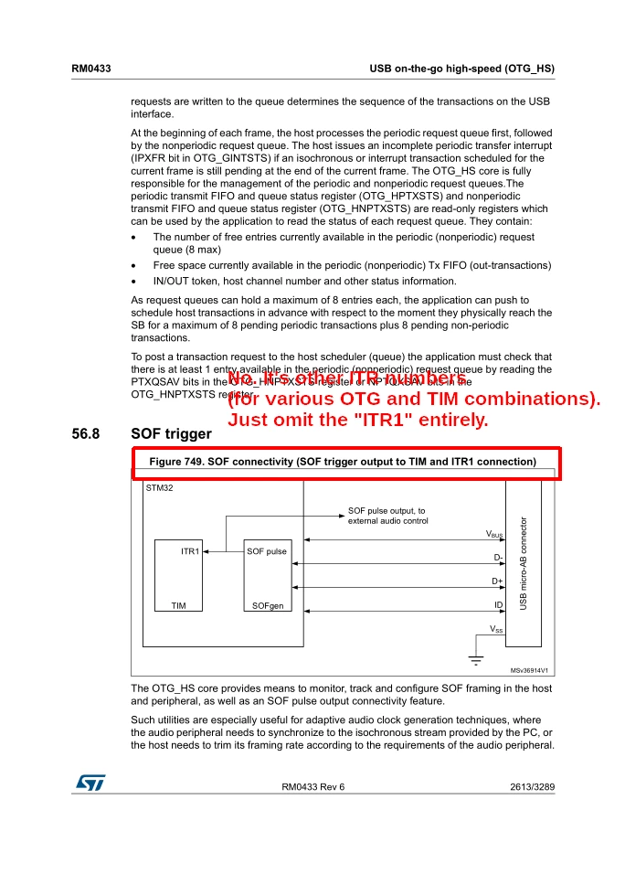

in 'H7 RMs, incorrect ITR description for OTG USB SOF-to-TIMER, in figure caption
(Spotted by sx107.)
I know the subject is not very descriptive, but a figure is worth 1000 words:
It's also in other 'H7 RMs; I leave it to ST to check them all :)
(Btw. this is a carryover from the 'F7 RM, where both OTG's SOF indeed feed into TIM2 ITR1, through a mux controlled by a bitfield in TIM2_OR.)

Hi @waclawek.jan
Thank you for reporting this inconsistency.
An internal ticket 188629 is submitted to review and update RMs including RM0399 RM0433 and RM410...
