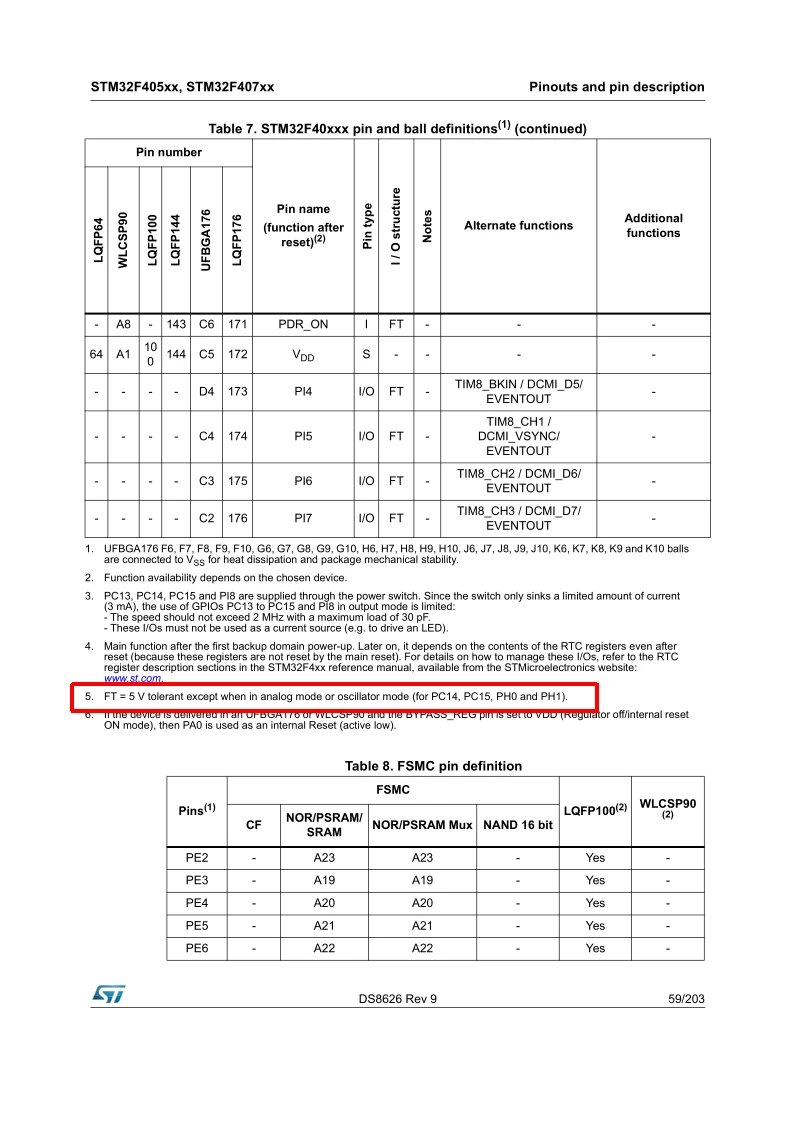

In 'G0, what's the input voltage range of FT_a pin, when analog function switched on?
In 'F4, for FT pins with analog functionality (marked as FT_a in other STM32 families' DS), there's a clear warning, that 5-volt tolerance does not apply when given pin is set to Analog mode:
For 'G0, I can't find any such description/restriction in DS; yet I am convinced that similar restriction will apply. Also, as @TDK  pointed out  here, the ADC "schematics" in 'G0 appears to contain a protection diode against VDDA.
To me, this sounds like quite an important issue, which may deserve more than just a footnote in DS (including a treatise in RM, too, in the Analog subchapter of GPIO); but in 'G0 we are left with guessing, which is definitively wrong.
This question probably applies to more/many/all non-'F' families, I haven't checked.
Also, I would like to bring up the difference between "pin set to Analog mode in GPIO" and "pin actually *used* in some analog functionality" (e.g. ADC mux is set to use this pin). This is even more important in the light of the fact that the default setting of GPIO in all newer non-'F' is Analog.
ST, please clarify, and please be meticulous in formulating the restrictions.

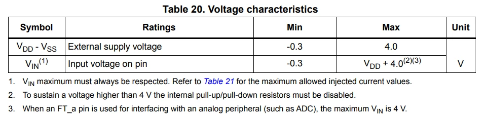

RomainR.
Mar 18, 2024 12:27 PM UTC
@waclawek.jan
May I suggest you look at the DS13866 Rev 4 datasheet for the STM32C0.
In particular table 20 in section 5.2 Absolute maximum ratings. and its note 3 (see below)
We propose to implement this same note in all the STM32G0 datasheet because the two C0/G0 families come from the same platform. It will be integrated in the next datasheet revision.
Thank you for your feedback.
Romain,

waclawek.jan
Mar 18, 2024 1:40 PM UTC
Hi @RomainR. ,
Now I am confused.
'C0 is not the best family for this discussion, as it does not have a standalone VDDA, as it is always connected to VDD.
Nevertheless, footnote 3, to which you refer, says, the the maximum voltage on a FT pin used as analog is 4V. Yet VDD=VDDA and VREF+ in 'C0 can be as low as 2.0V for the ADC to function (and these absolute range of VREF+ is in range of -0.3V..VDD+0.4V). That would mean, that according to what you've quoted from AN4899, at the allowed 4V on FT_a, it is surely far above VDDA, and the pin would be damaged by injection.
Can you please comment on this?
Thanks,
Simon.T
Mar 18, 2024 3:17 PM UTC
Hello @waclawek.jan ,
The AMR (Absolute Maximum Ratings) are there to explain that above a certain voltage/temperature/current the device could be damaged.
Concerning the voltage characteristics values, they are not meant to explain if there is injection or not. Just to give the maximum voltage where the product is not damaged without checking if the peripherals behind will work properly, but just saying that until this voltage the product is not damaged.
However the information given in the AN4899 or more particularly in the device datasheet ADC (Vain range) /comparator (Vin range) part are there as operational voltage.
I hope my explanation will remove you doubt.
Best regards,
Simon
