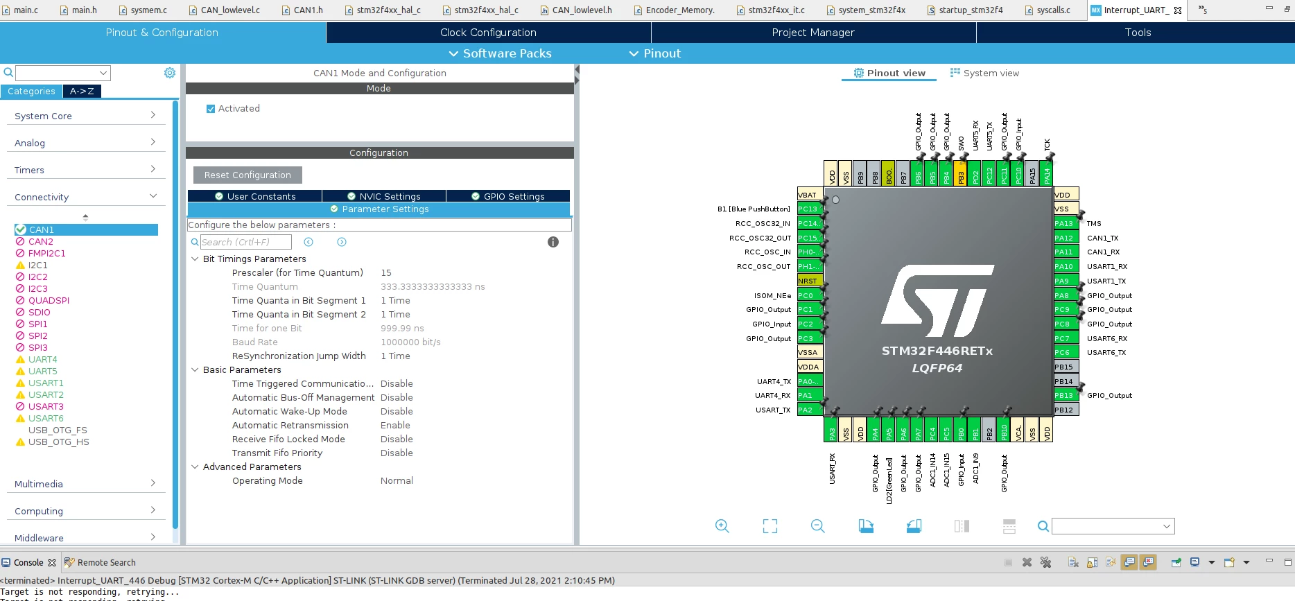

In CAN_ERR what is "Stuff Error" and what is "Form Error"?
I have a can bus operating between a PC and a Motor, where the PC can control the motor.
Eventually I want the STM32 to control the motor. For now all I want to do is read what is on the bus.
Looking at thedata with a CAN bus sniffer it looks like there are two messages going back and forth. About every millisecond the PC sends a command to the motor and the motor responds almost immediately. The bus sniffer says the two addresses are 0x05A0 and 0x0620.
I set up a 16-bit List filter with 05A0, 0620, 0000, 0000.
At this point I am only looking to see if the FIFO is not empty. It is always empty.
The CAN_ERR register changes. it is either 0xFF000023 or 0xFF000013 which tells me that the LEC (Last error code) is either 001 Stuff error, or 010 Form Error.
I have searched the entire 1347 page RM0390 Reference Manual and the only place Stuff error or Form error is mentioned is in the Error Status Register.
Where is Stuff error or Form error defined? If I do not know what it is how do I fix it?
Of course I would like to also know how to fix them.
I am programming a STM32 Nucleo-F446RE and the CAN bus is running at 1 MHz
I think my SW is upto date:
STM32CubeIDE
Version: 1.6.1
Build: 9958_20210326_1446 (UTC)
STM32CubeMX - STM32 Device Configuration Tool
Version: 6.2.1-RC2
Build: 20210324-1236 (UTC)
Attached is a screen shot of the MX Setup

I think I figured it out. Not by reading RM0390, but by reading TI documentation. https://www.ti.com/lit/an/slla270/slla270.pdf Section 4.10.

Bit stuffing is used to ensure a signal has enough edges in order for the clock to be recovered/sync at the receiving end.
https://en.wikipedia.org/wiki/CAN_bus#Bit_stuffing
A bit stuffing error means one of these added bits was the incorrect value.
Not sure what a form error would mean offhand.
Seems like there could be a clock mismatch between what the sniffer expects and what is actually on the line.

TDK suggested it may be a clock mismatch.
The oscilloscope tends to say it is correct,
So I changed the baud rate from 1 Mbit/sec to 100kbit/sec a tenth of the speed.
Surprisingly when I changed it on the Crouzet control program, and power cycled the motor it worked at the slower rate. So there must be some autobaud at the beginning of the motor driver power up.
On the STM32 it was a matter of changing the CAN prescaler from 15 to 150 in the MX program, and it said the baud rate went from 1 Mbits/s to 100 kbits/s.
It then generated the code and I was back in operation. But the errors still persist.
If it is a baud rate error from the clock being a little off, then by walking through the baud rates, I should be able to make it work. So I tried all prescalers from 130 through 170. In each case I was only seeing "Form Errors" and did not see any "Stuff Errors". But it never went away at any of the 21 baud rates I tried.
