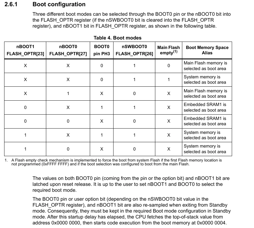

You are using PB6/PB7 pins, but according to the AN2606 Application note (see Table 176 – STM32L4Rxxx/4Sxxx configuration in system memory boot mode) you should instead use PA9/PA10 pins.
And since the STM32L4Rxx/4Sxx bootloader is activated by applying Pattern 6 (described in AN2606 Application note Table 2), please ensure that one of the required Pattern 6 conditions is correctly applied on your hardware so that the bootloader is entered.
For additional details and guidance, you can also refer to AN3155 Application note How to use USART protocol in bootloader on STM32 MCUs

thanks for your response, actually as per above information I am currently doing pattern 1 as I want to try to enter into the boot mode by hardware. i am no using any software configuration so, can I know the process for the same for pattern 1 (AN2606 Application note table :2).

according to the AN2606, the MCU STM32L4S is using the pattern6, not pattern1. You can also check the reference manual. for using the bootloader(boot from system memory), you need to set the boot0 pin Low, and nSWboot0 to 1, and make sure the Main flash is empty
