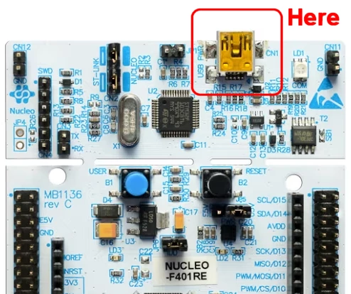

Im conecting the MKI through the IKS's DIL24 and the IKS on the nucleo's Arduino pins, and im unpluging the nucleo-pc cable
Andrew Neil
Jul 3, 2024 4:02 PM UTC
So you're unplugging the USB cable from the built-in ST-Link on the Nucleo board ?
So long as you don't do that during programming, that shouldn't be a problem.
Probably not a good idea to do it during a debug session.

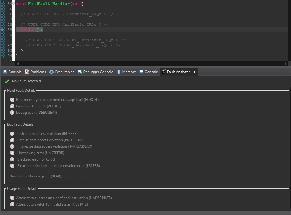

Ironically enough, the fault analisis display no faults... While i'm on the HardFault_Handler
I don't really know what to do about this issue as I ran the same program but with other sensors and they doesn't show this problem, I have another Steval MKI197v1 just to check that it wasn't a sensor related issue.
If (for example) i use the IKS sensors only, they work without an issue so i think it might be a library issue?
