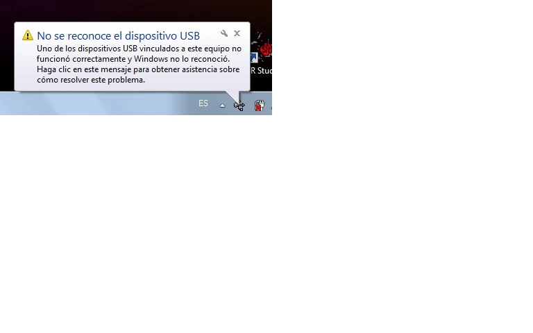

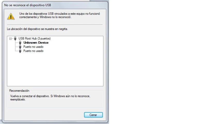

    Posted on October 20, 2011 at 08:19
    Of course, it is not a ''specialized'' development tool, it is just an evaluating board to introduce yourself to the world of STm32. i think so.
    But, my main problem is that board does not work with St link utility. i pluged, it starts blinking, but st-link utility does not recognize. is like stlink, on board does not have Bootloader or firmware that manage the usb protocol, is it possible. let me put a picture. sorry about but my native language is spanish, and how you see, my operating system too.

    Posted on October 21, 2011 at 03:50
    actually, i did it.
    you know what???
    i change my usb cable, and guess what?? windows recognize stm32vl as massive storage.
    olso,  i could compile the demo on atollic.... but,,,, unfortunately i can not program or debug it..
    really, it is so wear... i hope someone knows the answer??

    Posted on October 22, 2011 at 09:00
    it could possible.
    i can fix it up,,, maybe.
    but i still having the common problem that none of ide detect board, stlink utility does the same thing.. whats happening?

    Posted on October 22, 2011 at 10:15
    In previous post, you claim that it was detected by changing USB cable. Can you please explain the errors you are getting
