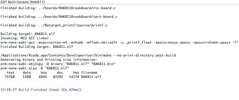

    Sabas Sabas
    January 24, 2018
    Posted on January 25, 2018 at 00:49
    CoIDE build
    Andrew Neil
    January 25, 2018
    Posted on January 25, 2018 at 01:26
    Does it build successfully in CoIDE?
    If it does, then you just need to go through all the settings, and make sure that you have the same in SW4STM32

    Sabas Sabas
    January 25, 2018
    Posted on January 25, 2018 at 19:56
    Compiled! with some warnings
